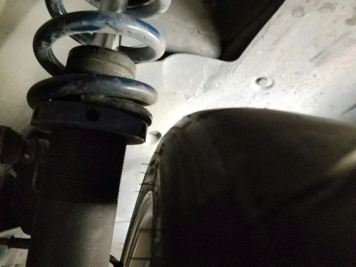

Here is a photo of my current clearance. I do not have camber bolts installed yet.

I know with my camber plates, the strut and the wheel move in unison when camber is adjusted. Clearance appears to be the same regardless of my camber setting. I guess this is not the case with camber bolts?
Correct. With camber plates everything moves as one. But, the camber bolts actually change the angle of the wheel/hub in relation to the strut body.
You are correct sir. The BMR camber bolt replaces the stock upper strut bolt. So when you adjust it, you pivot about the lower strut bolt. So you get more camber even if your strut is maxed out on your camber plate.

Ah so you are adding more camber beyond the camber plates. Something I, at least, don't need at this point. Although, I'd almost rather slot the strut vs. use a camber bolt. But that's just me...
Yeah, there are pros and cons for each...

I wonder if a 305_35_19 pilot super sport would fit up front on these?
With my setup, yes. With killspray's, we need to measure the clearance from the top of the tire to the spring perch. My guess is that it would clear.
We will be taking measurements and pictures soon.
