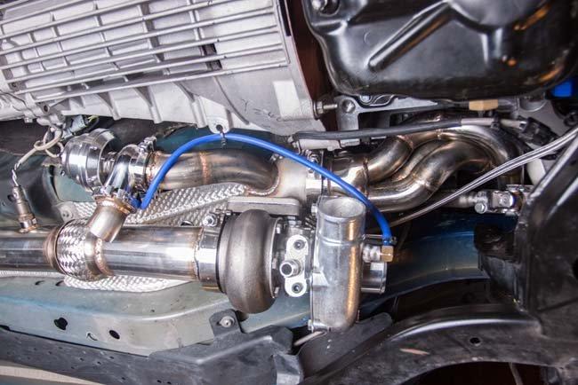

So, came across this on facebook today. CX Racing makes a full hot side kit for bottom mount twin turbo system for S550 cars for only $1200. Also includes custom headers instead of reusing stock. Pair this with On3 turbos, which are proven and thats pretty damn cheap. I know cx racing made a turbo kit for s197 coyotes, but never seen one in person. I'm honestly impressed looking at pics. THoughts?
https://www.cxracing.com/products-b...KIT-50-MUSTANG15-ONLY?sort=p.price&order=DESC
Looks like they also have it paired with coldside for 1800

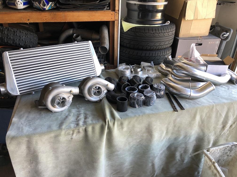

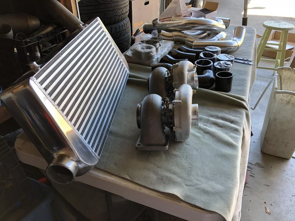

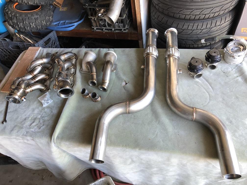

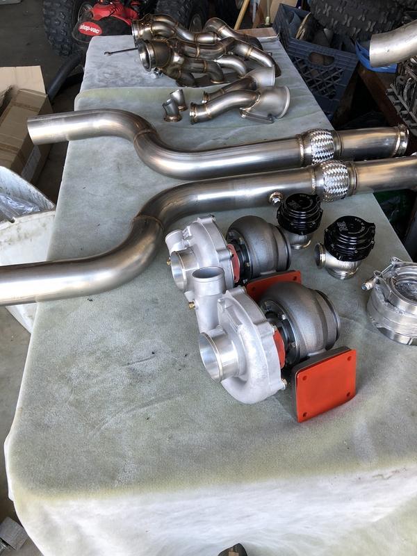

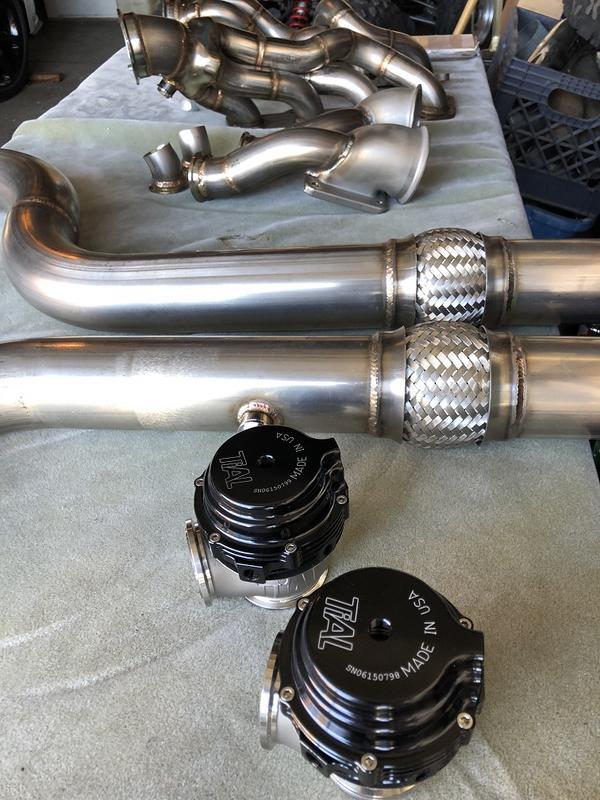

They not only make a hotside, but also a full kit minus turbos and oiling and fuel.
I bought the complete kit last week and am still collecting parts so my car wont be running until next month or so.
I also bought two of their 67mm billet wheel, dual ball bearing turbos... $520 each!!! They appear to be damn near identical to the magnum 67mm turbos which were also available in the s197 On3 TT kit for 11-14 cars.
I am into mine for far for right at $2600 but I deleted the wastegates and am going to run Tial 44 MVRs that I had sitting on my shelf for the last 2 years.... The hot side quality appears to be great.

Did they give you an idea of what the kit is rated to be able to put out for power? Also what size runners are on the headers? I’m very interested in this kit as it does look very nice.
