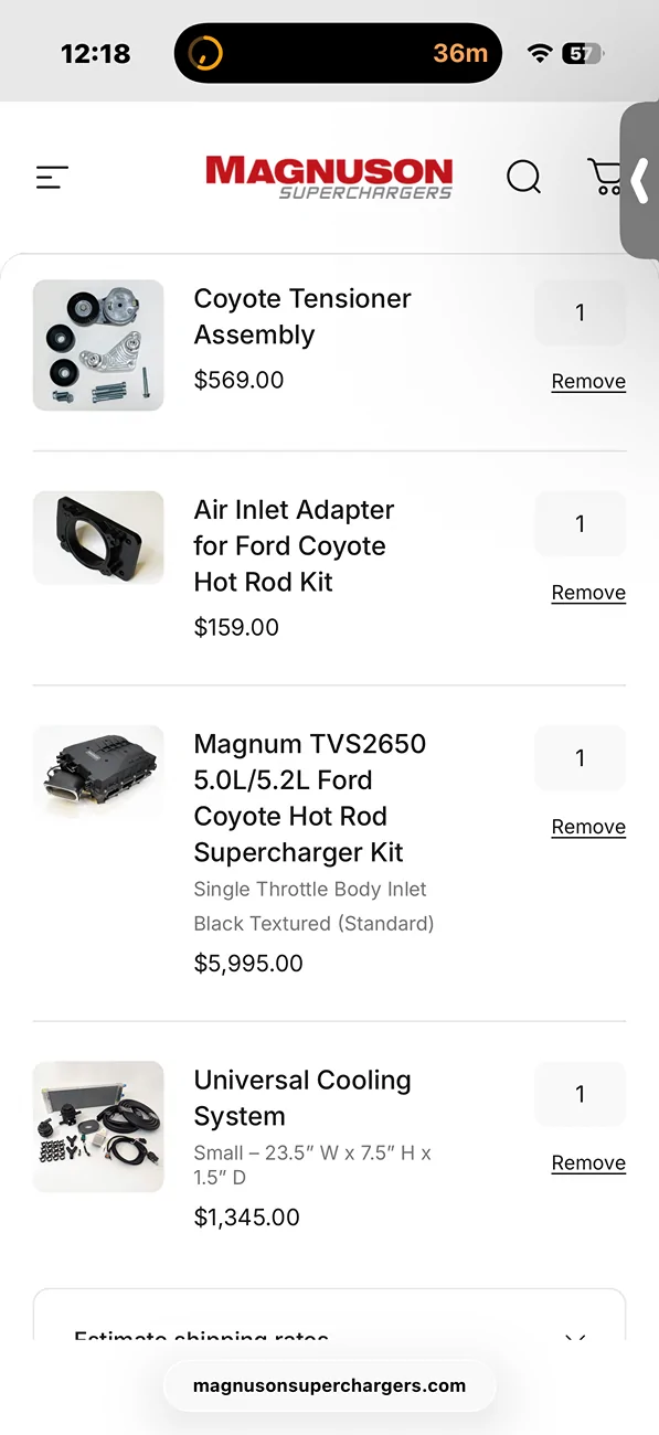

So I recently been extremely obsessed with boosting my Mustang I have a 2020 A10 Mustang I have billet crank sprocket grip surface and oil pump gears with billet back plate I have decided that I want a roots style blower with eatons TVS 2650 internals and I see Magnuson has a supercharger head unit that’ll bolt on a coyote but it’s a “hot rod” the good thing about it is I can buy each part of the kit separately but I want to know if there’s more that I need to make this work on my 3rd gen

ima call Magnuson today and see what they can do for me this path is easier for me to buy things in stages than just dropping 10k on a whole kit and I always wanted a VMP Odin but alas VMP and magnuson split before I was ready for boost

Found out today that VMP still sells parts that would’ve came in the Odin kit so I just might mash a list together sourcing parts for the Magnuson as if it was a Odin same exact head unit

Only thing I haven’t been able to find is a throttle body I would hate to use the stock coyote throttle body for this
