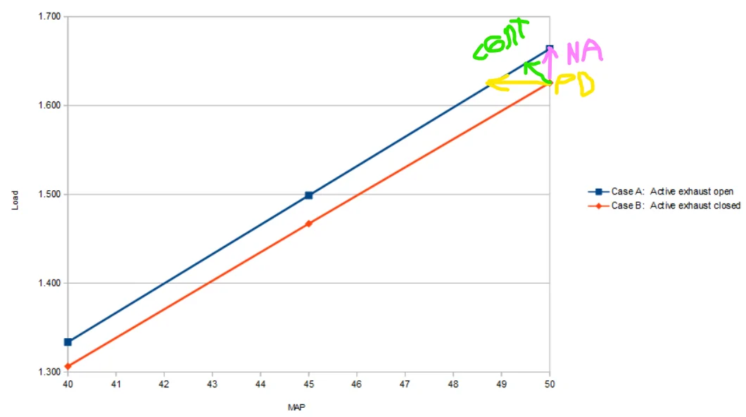

That said, I modeled the OEM speed density calculations of a Gen3 coyote in the boost range with active exhaust open and closed to demonstrate the difference it makes to VE:
With active exhaust open, you get more load for any given manifold pressure. It took a second for that to sink in. Basically, if you reduce exhaust backpressure, for any given manifold pressure, more air makes it into the cylinder, not less. This means less backpressure leads to more cylinder pressure, more propensity to knock, higher stresses, etc. Yes, it seems backwards at first, I will admit. Then again, with an NA engine, you would expect it to flow more air if you reduce backpressure, so why would boosted be any different. The purple arrow above shows what happens to air load when you open the active exhaust on a stock engine (imagine it's at 27 inHg), as the manifold pressure stays essentially the same thanks to the atmospheric nature, and you get a vertical increase in load.
But when you toss a supercharger into the mix, it gets even more confusing. A PD blower doesn't care too much how much pressure it's pumping into; it does practically the same flow regardless. Since cylinder air load = MAF/rpm/4/.0017, that means that the load does not change at all if you reduce exhaust restriction (yellow arrow in graph). But a centrif is different, being a dynamic compressor if you reduce the pressure it's pushing into, it actually flows more air similar to NA. So, with a centrif, much like NA, reducing exhaust restriction results in more air load, more cylinder pressure, etc. However, due to the nature of the centrifugal compressor curve (lower pressure means more flow, but due to compressor limitations it's not a vertical line) you get some increase in flow, and thus load, for the decrease in manifold pressure (green arrow).
In summary, if you reduce restriction and increase boost to get back to original levels, it's not getting you back to the same safety level as prior. It's actually pushing you in the less safe direction twice instead of once.
