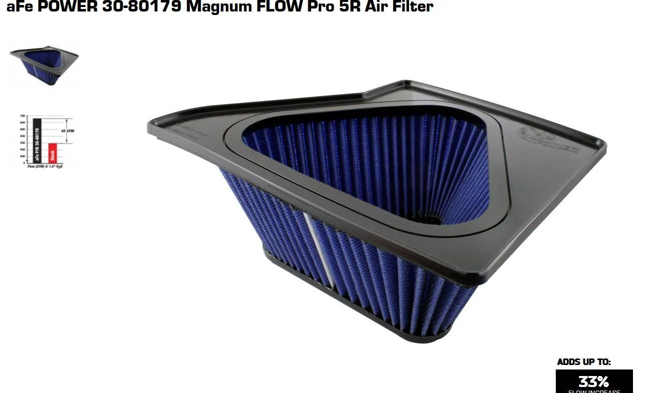

Good point on the 90-degree bend. It initially appealed to me because I ran this filter in the stock airbox on my S197:
Opening up my side grille, my tuner said he found that this setup was 95% as effective as an aftermarket intake without IAT issues from an open inlet or metal tube. Thus, the Injen seemed to be another iteration of this concept, though a straight path, as found on the GT350/ROUSH, might very well be preferable. I emailed AED and will wait for any feedback. Thankfully, time is on my side, so I'm open to going through the research process. Alternatively, if two companies want to give me their intakes for free, I'll dyno both, back to back :)
