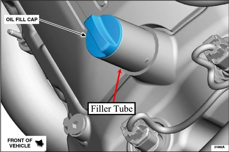

I have 3 dental mirrors and none them fit through the hole in the filler tube. Does anyone know how to remove the plastic filler tube from the valve cover? The service manual was of no help.
