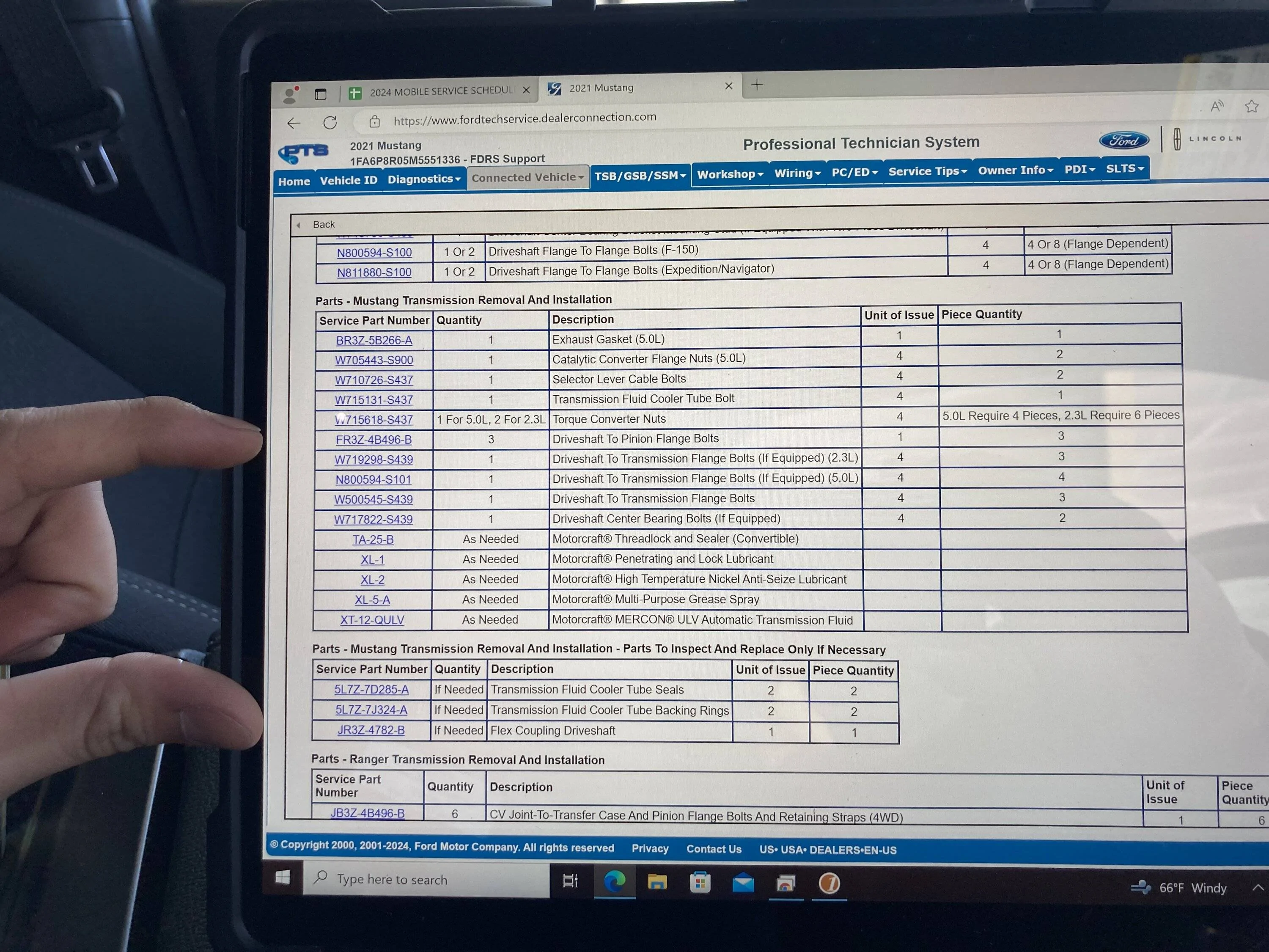

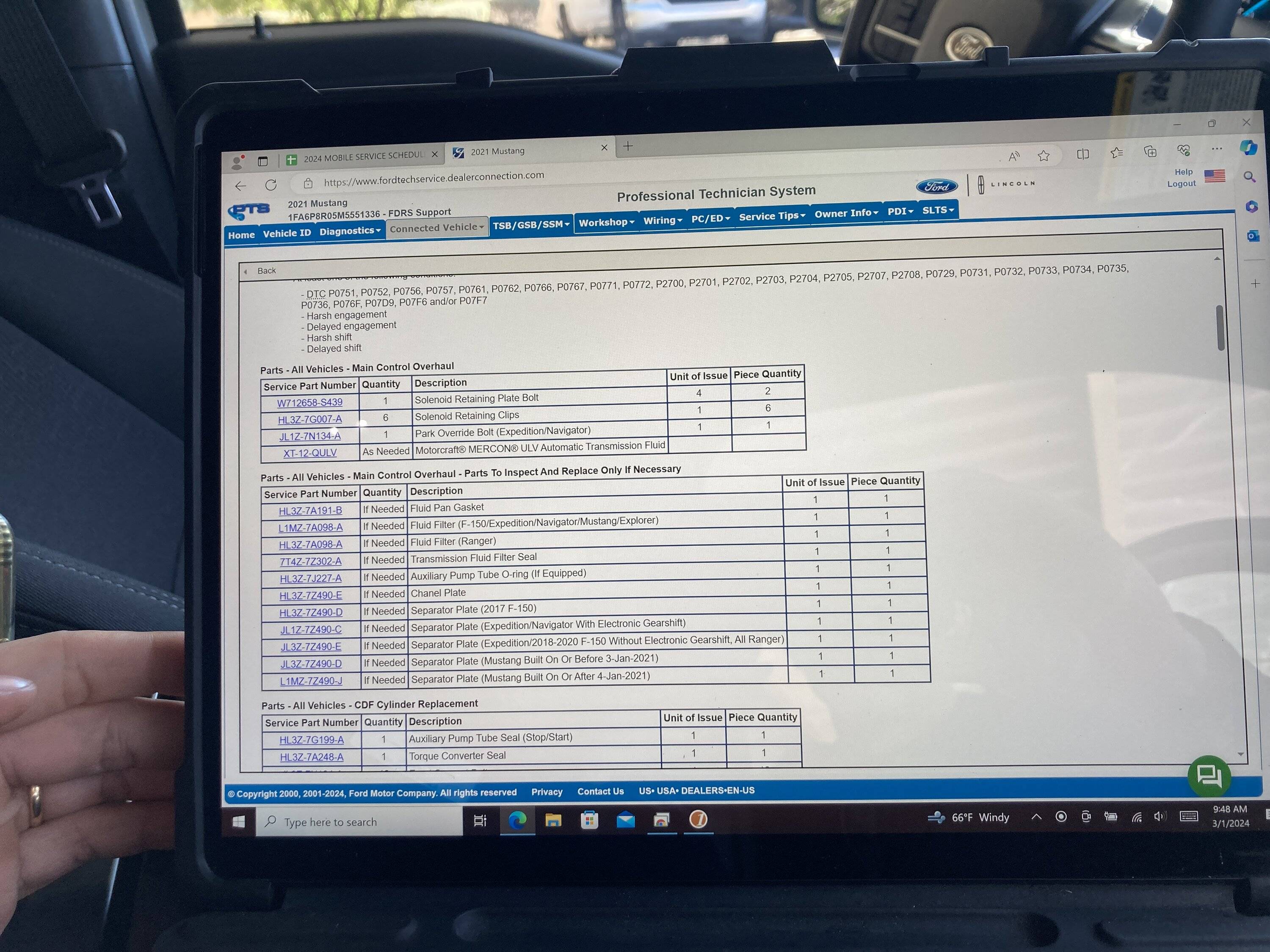

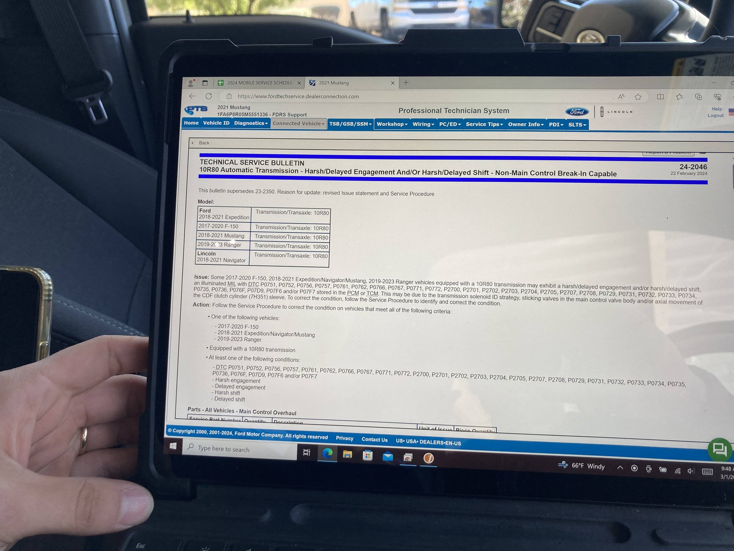

The above TSB was just released last week for the A10. I’m not sure how many saw the updated TSB, but here are a few pics. I had the body control module update yesterday and I asked the Ford tech about it and he showed me what was involved with it.

Gotcha covered; we keep 10R80 TSB’s updated here:
https://www.mustang6g.com/forums/threads/2018-10r80-a10-most-recent-tsb’s-in-here.102918/page-8
2046 was released Feb. 22, 2024. The thing with TSB’s is they are not sent to any owners of affected vehicles, they’re just an internal “FYI” for the Ford Techs to follow known possible diagnosis concerns and fixes. TSB’s are usually covered under warranty periods (3/36 and 5/60 Powertrain), but once outside those windows, cost is on the owner.
