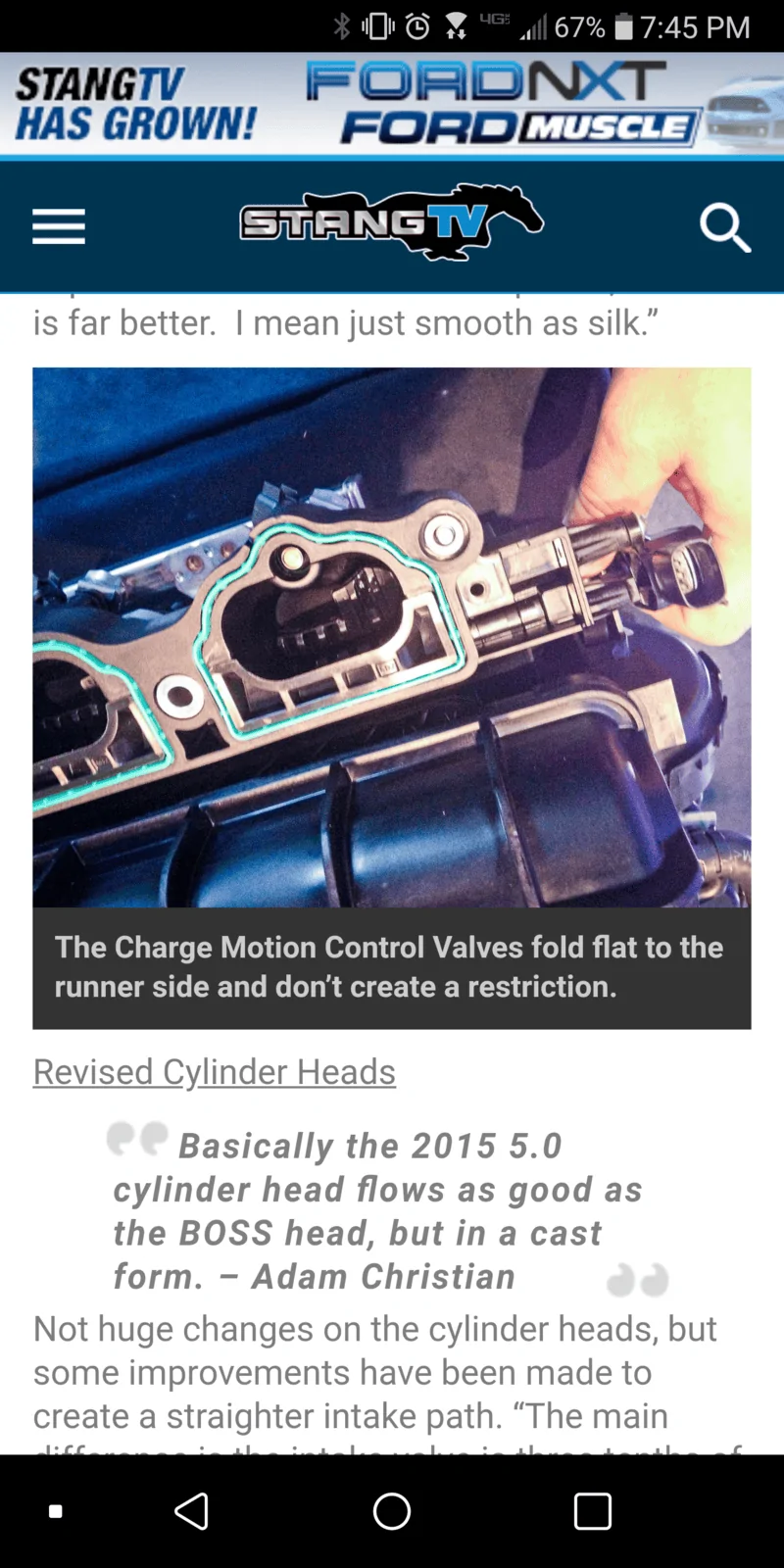

As in previous Mustangs...the IRMCs have a rod through the intake runners with small throttle blades screwed into them. As opposed to just “locking out” and still having an obstruction in the intake runner, has anyone actually removed the IRMC completely and free up runner much how the Cobra Jet has no obstruction

It's a very, very small obstruction and one that is eliminated by porting. The CJ manifold makes more power because of the direct feed from the plenum, the runner lengths and huge throttle body inlet.

There is not. The runner is almost completely open when the IMRCs are open, and the porting will smooth out the edges that are just barely in the flow.

I thought the same thing a while back until I got my 18 mani. Now after seeing it there is nothing to be gained by removing the valves. They are beautifully tucked into the molding for them when opened.

The same is true on the 15-17 manifold.

+1 I have looked at them on the 18 mani and the GT350, they fold perfectly into the manifold. If you removed them you would then have a large space in the manifold wall and I'm sure that would disrupt the airflow more.
