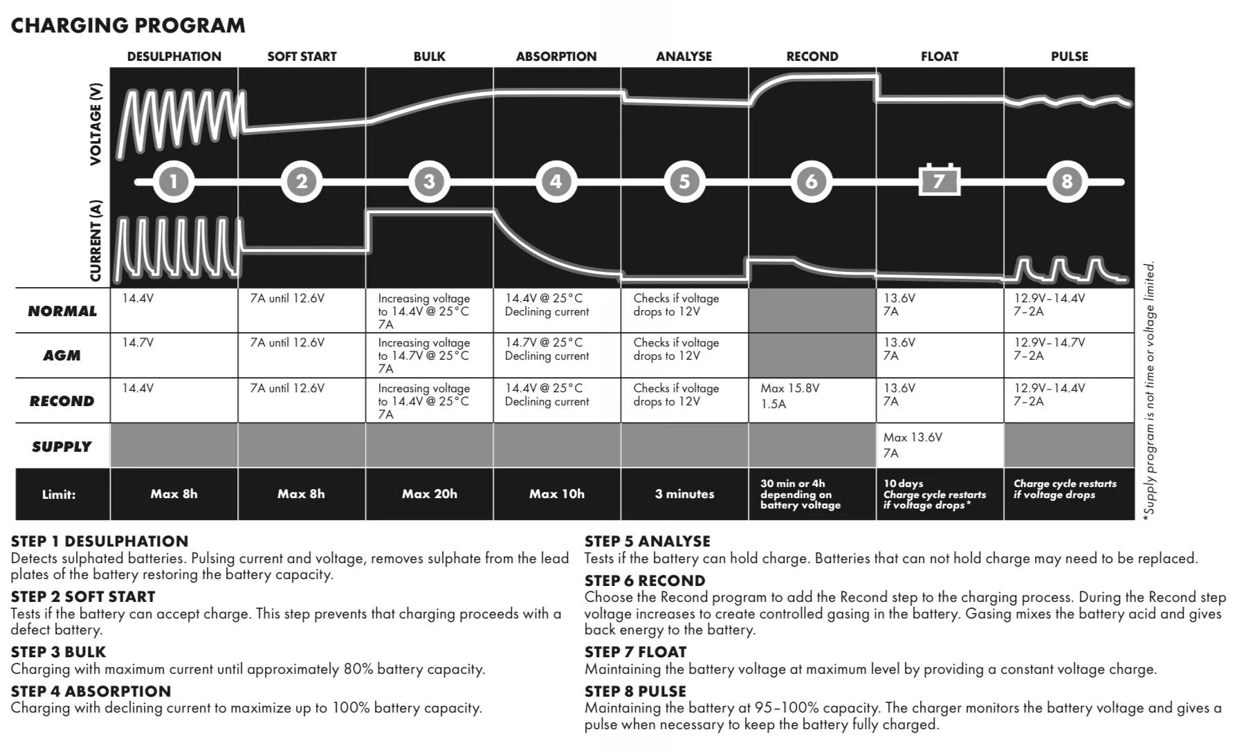

@WD Pro previously provided the attached. Thank You. It references the CTEK unit, which also goes by other brand names.
If you had not used the unit before, if you were curious...it generally takes my car an hour or so to go through the first thre stages. A few hours after that, it has progressed to stage 7. I noticed last night, I finally reached stage eight and am holding there. It took close to two weeks to reach 8. YMMV.
