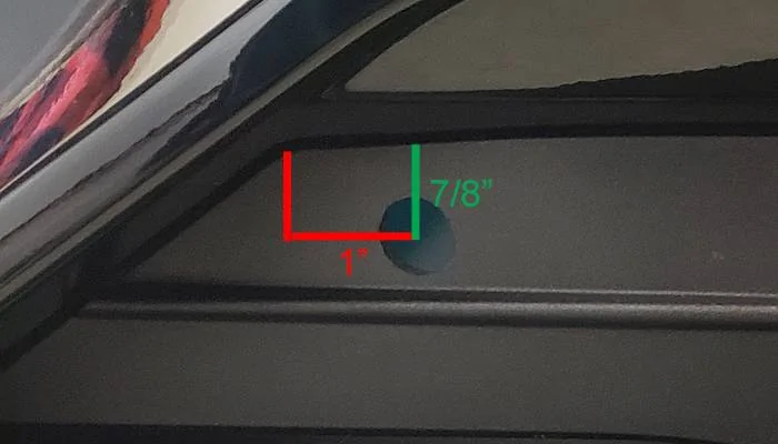

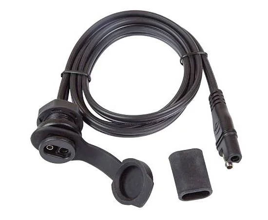

Wanted to share an installation which I’ve not seen before that I’ve used on my 2022 GT convertible – it’s an external connection. The primary part needed is the OptiMate O-40 weatherproof SAE socket cable OptiMate CABLE O-40 - OptiMate (optimate1.com).
The front bottom cover of the engine compartment needs to be removed. This is not a difficult task – just awkward to remove the screws all the way around without the front end being raised. A 11/16” hole was drilled in the solid part of the lower honeycomb grille on the lefthand side. The center of the hole should be 1” horizontally from the top left corner and 7/8” below the upper edge of the solid part of the grille.

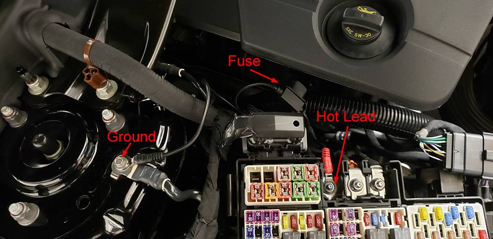

This placement will allow the front shoulder of the fitting to rest flat against the solid part of the grille and avoid the grille clip on the back side. After center punching the location, a spade drill was used to make the hole and it provided a very clean cut in the grille material. The wire was fed into the hole and then the rubber washer and nut placed on the wire. The nut was tightened onto the fitting until it was firmly snug and the rubber washer flattened against the back of the grille. Next a flimsy piece of coat hanger with a hook shaped end was inserted from the top of the engine compartment and the 40” wire pulled up. Facing the engine compartment, the wire was fed under the left side braces of the fuse box until the connector was exposed at the rear. There an Optimate O-11 weatherproof battery lead with fuse OptiMate CABLE O-11 - OptiMate (optimate1.com) was connected to the 40” lead and the black lead ring to a stud on the upper strut mount and the red lead ring to the hot terminal in the fuse box.

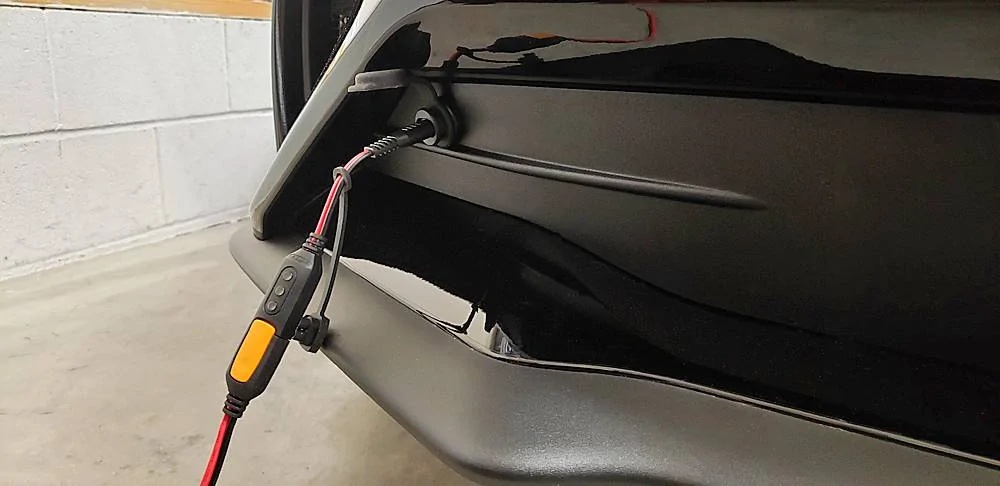

Here’s a photo in which my CTEC Multi US 7200 is being used. The connection wire from the grille fitting to the tender lead is the CTEK 4269 battery charger comfort indicator pigtail adapter which can be obtained here: Amazon.com: CTEK 4269 CTEK Battery Charger Comfort Indicator Pigtail Adaptor : Automotive. Again, for emphasis, any SAE connector attached to a tender line will work just fine.
