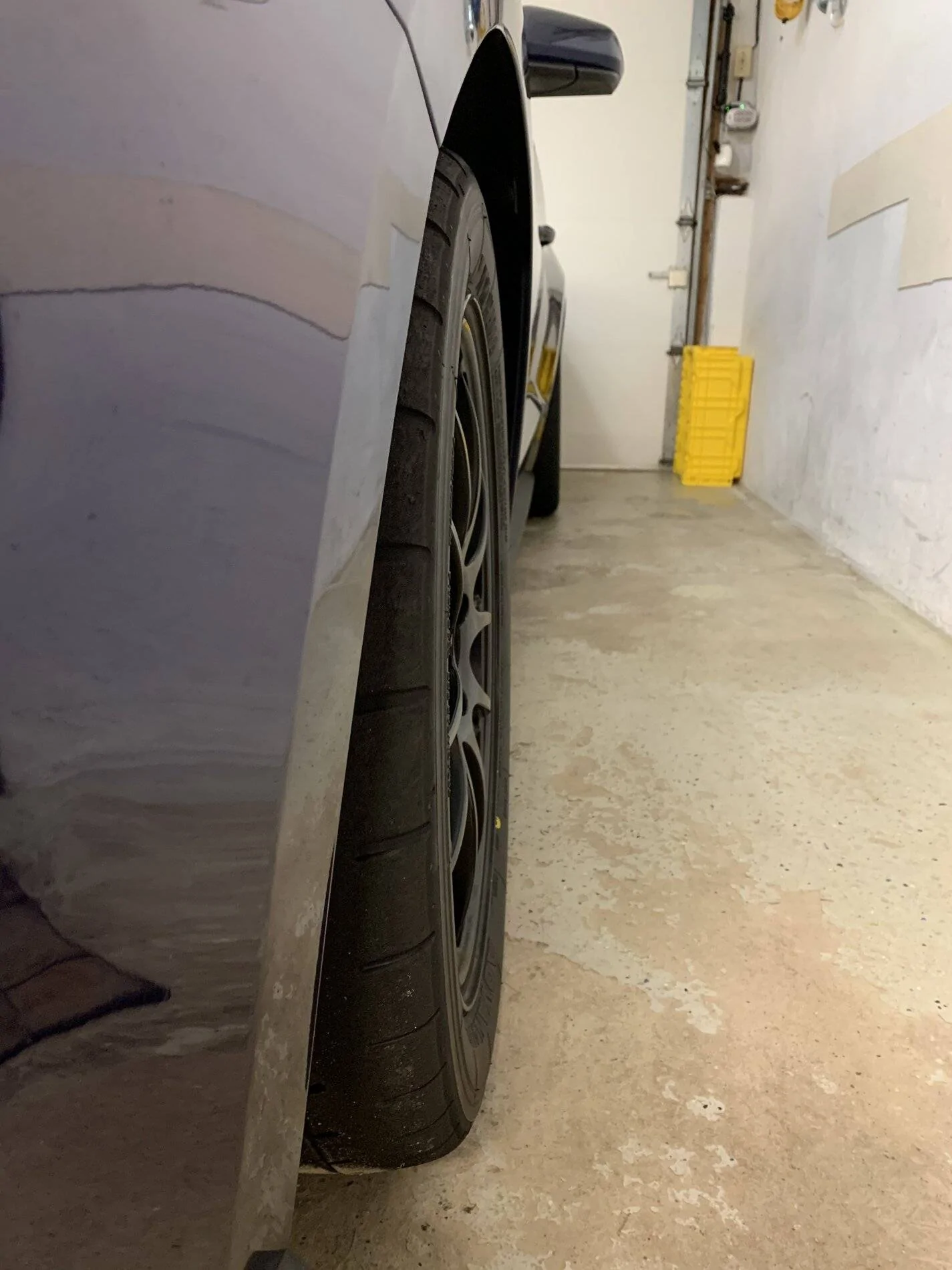

I don't want to put 275's on the front 9" rims.

Ya 275 is barely visible as pinched. You have to look pretty hard to even notice, even with the 275/9.5s and 275/9" wheels side by side.

40's will have more bulge. Plus I don't want to start mix matching.

My 2 cents, I agree with the previous post to just put the same 275/40 on all 4 rims. There won't be enough difference with just a 1/2" narrower rim to really see it or feel it. A 40 ratio tire shouldn't bulge any more than a 35 all else being equal.

Actually, it will be less. Look at the manufacturer recommendations. As the side wall gets taller, the minimum recommended wheel width tends to get narrower.
