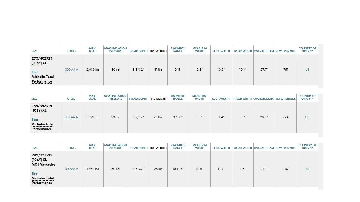

I'm running performance pack wheels right now but I'm planning to go square setup.
I deciding on between 285/35/19 and 295/35/19.
I'm looking on tirerack at the tread width section (I'm assuming the contact between tire's and road's surfaces).
My 275/40/19 has 10.1 tread width, 285 has 10.0 and 295 has 9.8.
So what's the point going to 285 or even the 295?
I'm a little confuse so hopefully someone can explain it. Thanks.

Yes I'm looking at the same brand Michelin PS4S. The section width gets bigger with bigger tire as expected but the tread width is what I'm confused about. It should get bigger too. Did tire rack got the number wrong somehow?

Unfortunately, that isn’t always the case. It’s possible that the numbers are incorrect but I doubt it as Tire Rack measures the tires (or so I’ve been told) The last option says ā€œMO1 Mercedesā€ indicating that the tire is made to spec for Mercedes so it’s not unusual for the tread width to be larger/smaller than the same tire that’s not a ā€œspecā€ tire. Another example would be the MPSS. I was in the market for 295’s as well and found that there are three different 295/35/19 MPSS tires. There’s the plain Jane non spec one which has a tread width of 10ā€, an MO Mercedes spec tire with a tread width of 10.3ā€, and a Star BMW spec tire with a tread width of 10.4ā€. All of them list a section width of 11.9ā€ though

Definitely odd that those ā€œlargerā€ sizes are smaller, but with the Mercedes spec tire its not that unusual for it to be a bit off the others.
It is what it is. Most of the time larger sizes will be larger. Good to check the actual specs before you buy.
