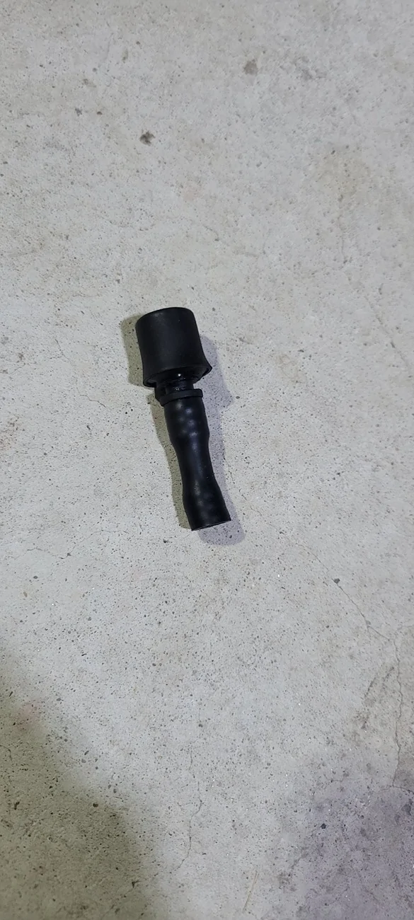

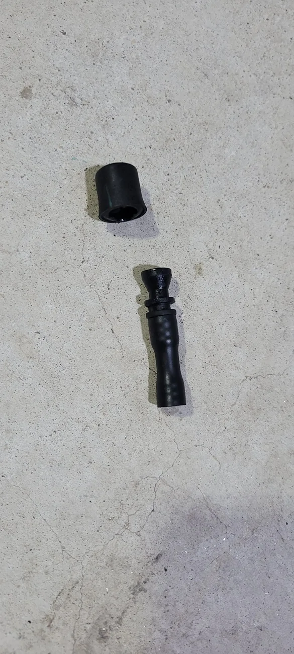

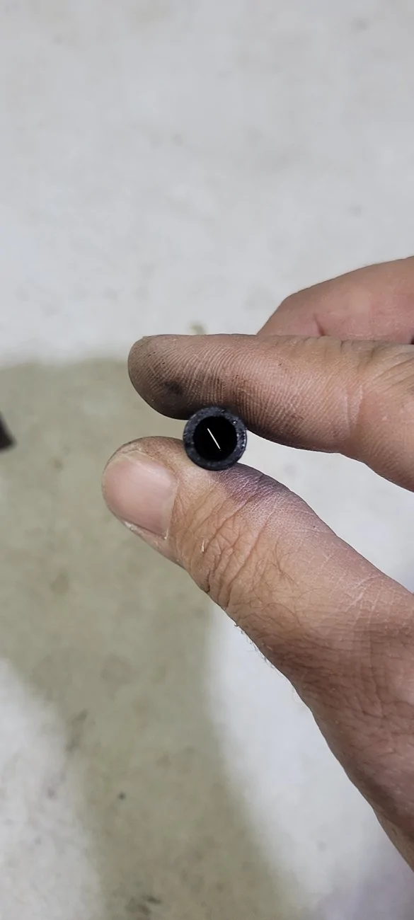

The purpose of the vent is to allow air to vent when the oil warms up inside the gearbox. It is not meant to pass oil. Most of the time the leak is from where the breather attaches to the transmission.
The best fix here is to drop the gearbox for room and properly attach a fitting and hose which is poked through the transmission tunnel and attached to the firewall. This will never fail again.
ps never go to a Ford dealer as they can only reinstate the crappy design adopted by the manufacturer.
I took a pic and added a few extra breather holes on the cap and havent had any issues.
