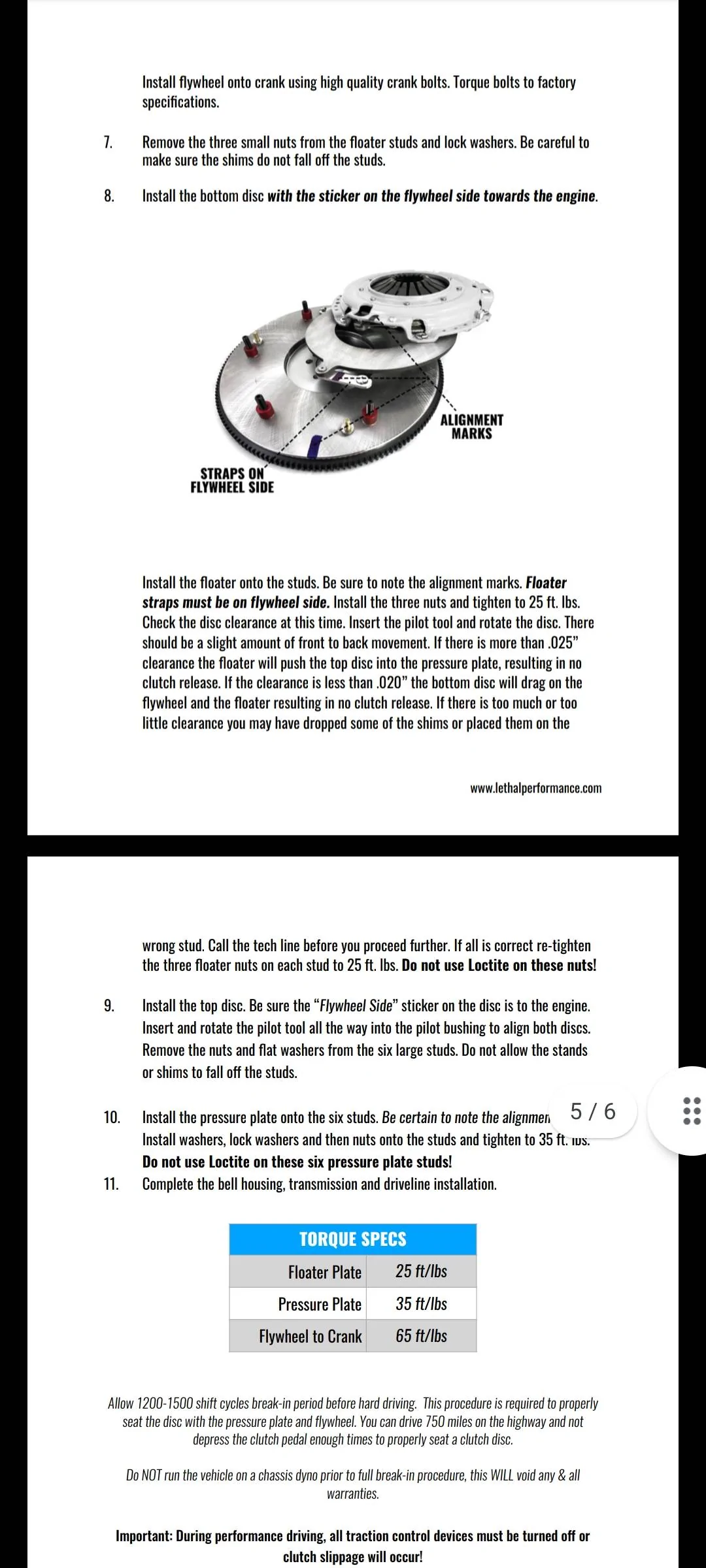

Sounds like clutch drag on the lpx. I had the exact same symptoms at first too. Sometimes hard to go into first and reverse and dropping second was a pain at high rpm. My clutch wasn't shimmed properly at first. It's much better but my trans had to come our 3 times to get it there. Did you check clearances and adjust the shims at all during install?

No I didn't shim anything. Didn't know I had to. Directions to install the clutch didn't mention anything about it that I can remember, and I know it didn't come with any shims. I'm gonna have to look more into this. What did you use to shim? Any write up on how to do it? Thanks for your input!

There are round shims (like washers on the studs) in between the flywheel and floater plate. Interesting your instructions don't mention checking the clearances between those. Mine did so I followed it and it was way our of their spec. I called lethal and they put me in touch with mcleod who instructed me to remove shims until It was with in the spec given. After I got everything together it was exactly like how your describing yours. I tried bleeding the clutch and messing around with it for a while but no change. Then my brand new slave went out so I assumed that was my issue. Pulled the tranny swapped it out and put everything back together but same symptoms. Talked to mcleod again and this guy told me the opposite of what the first guys said. He said I never should have adjusted the clearances it was preset when they built it and that note in the instructions is only for adjusting the clutch later on to get more life out of it. Dropped the tranny a third time and put it back the way it came and all was good.
There should have been round shims on each stud between the flywheel, flex plate and pressure plate. Do you think they could have been mixed up? If so or if any weren't put back in the right place as you installed it, that could be the issue. If everything went back into the right place then you may need to contact lethal. If you send the clutch back in they will get it re-adjusted. Once it's all set the clutch is pretty bad ass. I like it's street manners and the way it holds power.

The note at the bottom of #8 is what I was referring to. My clearance was over .035" but apparently that's where it should have been. Not .020"- .025"

I vaguely remember something about this. I had a lot going on when we put the clutch in so maybe I forgot about it. Maybe it was just that I made sure not to drop/lose any of the washers. Looks like the trans is going to need to come out regardless at this point. How did you check your clearences?
You just use a feeler Guage between the flex plate, first disc and flywheel. But if you kept all the washers in the correct place then this should be a non issue.
