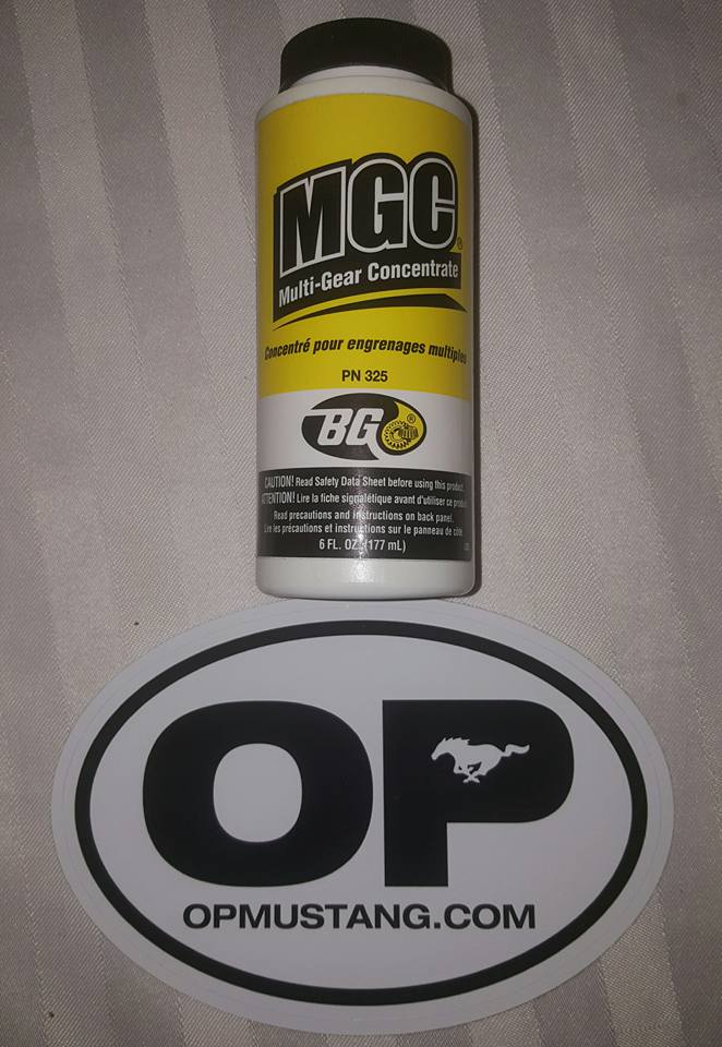

You could give THIS a try with the RP. It may help.
What is it? What is it used for?
Awww heck. I just ordered some from Optimum. I'll follow up after I get it and put it in.
Thanks!
John
It's magic stuff! I get the smooth, slick shifting feel of the BG with the cold shifting performance of the RP.
RP+MGC=:headbang:

Basically a super additive package. BG keeps things pretty close to the vest.
Got mine today and put it in. Drove about 30 miles and shifts are getting smoother and smoother... Great stuff so far!!!
I'm guessing the BG SyncroShift already has this stuff in it. I mixed it with my RP and love what I got! Cold shifting goodness and creamier shifts when warm.
