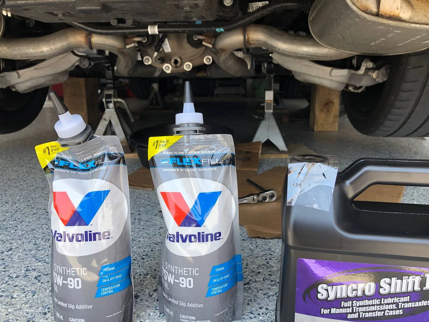

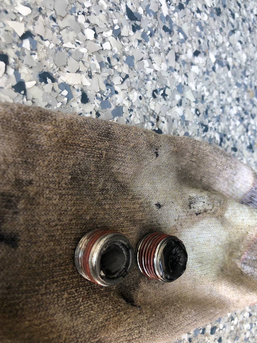

Did the change today. The rear took both quarts. Nothing overflowed. Took the top plug out again after a ride and still nothing.
The trans used everything minus the supplied cup to measure exactly what's supposed to be left . Car only had 19K but I ve done all the fluids (other than coolant ) since I purchased it so I m all good now.
Diff plugs.

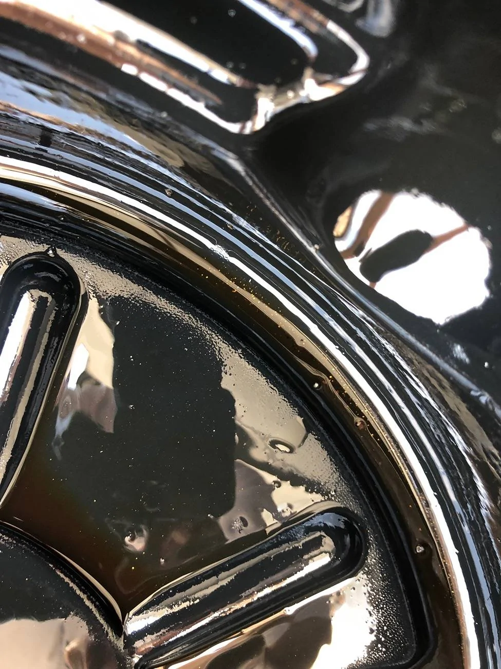

BTW, I never asked, old fluid from trans had some gold metallic fine particles. Magnetic did not pick them up. Someone told me that just a coating that was on parts? Thanks.
Seeing some fine metal particles is normal. There are bronze components in the trans which look a lot like gold. Also, bronze is not magnetic.

is that a wear thing or a coating as someone said? Decent amount.

disregard the inside but look at the edge (rest of pan had other contamination not related). Gold. Trans working fine. Wish I had have cleaned out pan before hand.

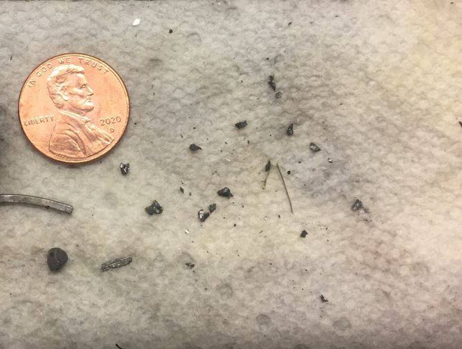

I think its just normal wear and tear. Looks almost salt like in size. If you had pieces that you can actually pick up with your fingers, then I would be concerned. Here's an example.
