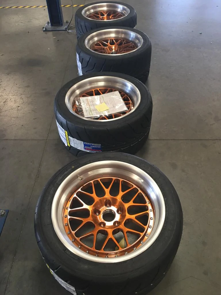

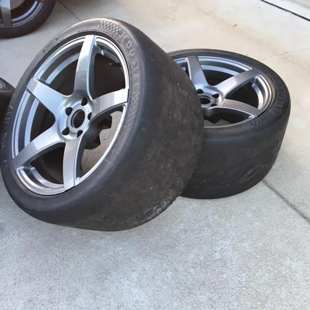

For those that asked, here are 2 of the wheels and tires that I had a pic of on my phone. I will try and post more later today..possibly mounted up
