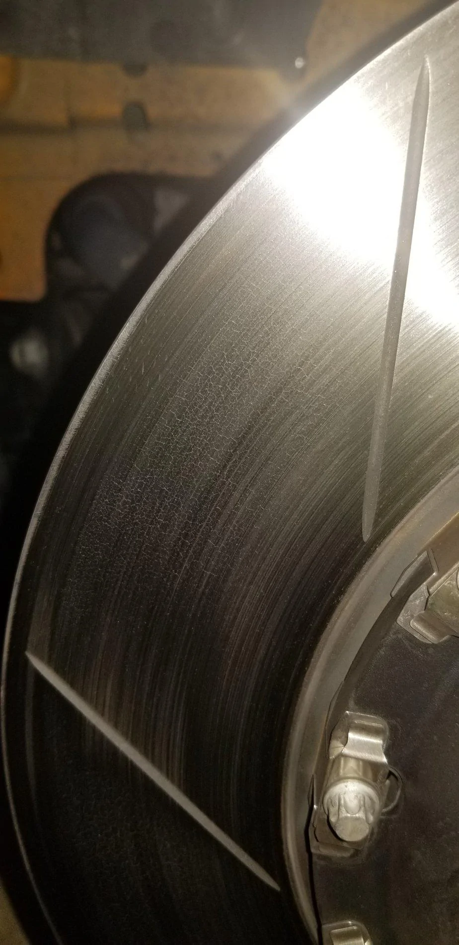

So after I've bedded in my racing pads/rotors they are a little loud, but after my first track event with them they are super loud. While braking they create a loud drone/rumble/low vibration and I'm wondering from those who run track setups if they are generally pretty loud when braking or if I should try to resurface the rotors. I know there is a higher metallic compound in race pads and metal on metal is going to make a lot more of a harsh noise. Just nervous about resurfacing the rotors since I just put on 1300 dollar rotors and there doesn't seem to be a lot of pad material on them. Dont know who to trust to resurface them without taking off a lot of material.
Seems to be coming primarily from the front. No squeal, shimmy ect. Slight vibration just from the low rumble sound/drone while braking moderately increasing in volume with increase to heavy braking.

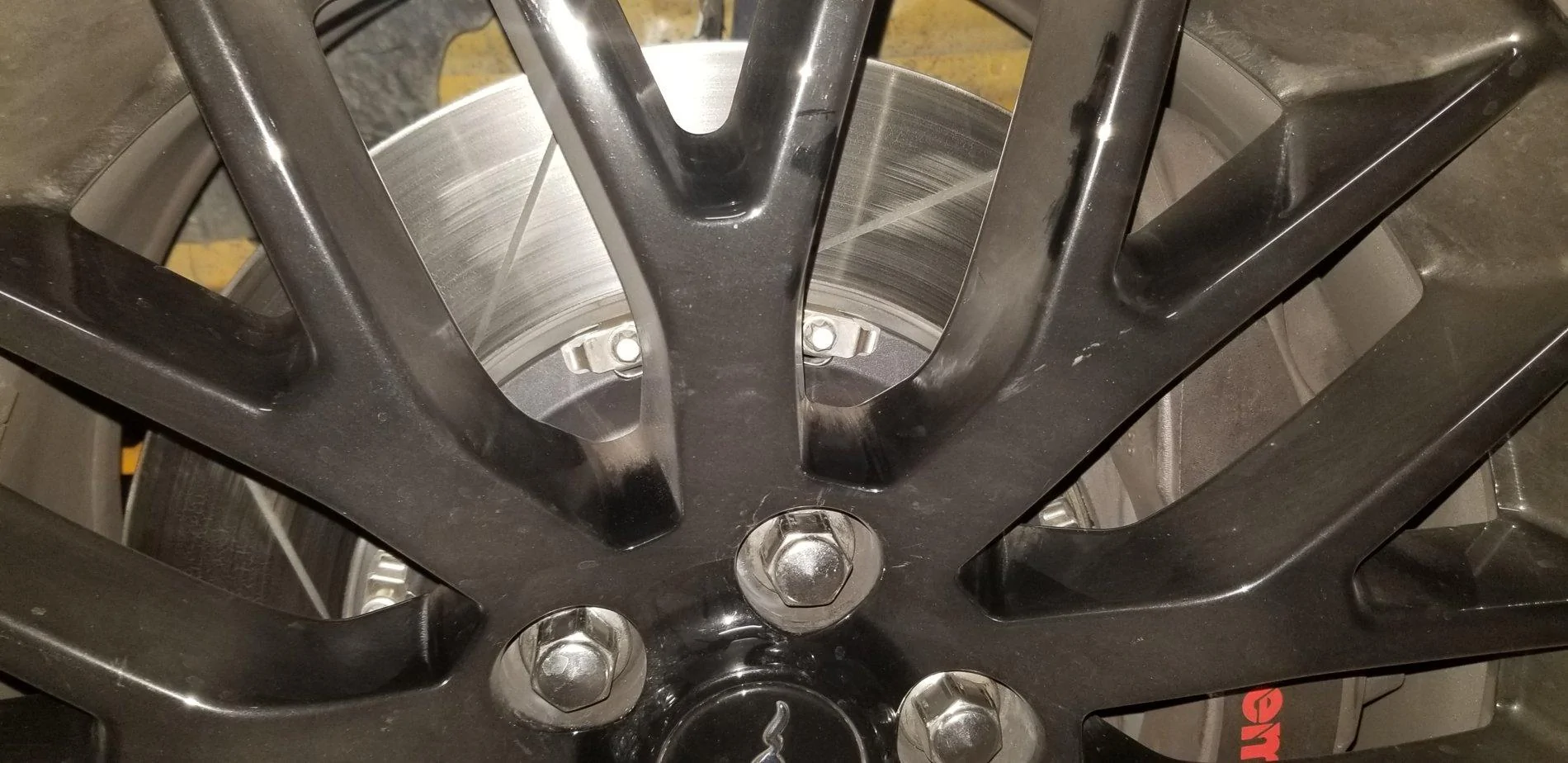

Yes I seated the pads before the track event. I'll take the wheel off for a better pic but again, doesn't seem like there is excess pad material on the rotors. Prob need to be resurfaced. I'll see if it's better/worse after my next track event in a week.

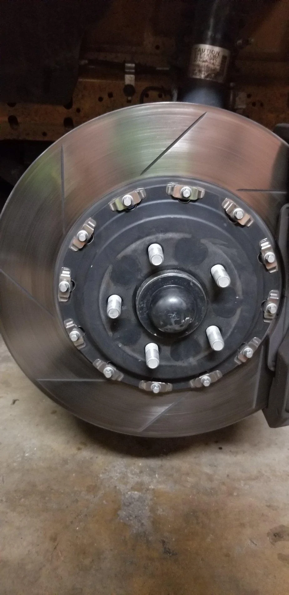

Break in called for 10 stops 60-10 and 10 80-10. I got prob 8-10 60-10 and 6ish 80-10 stops due to city road limitations. I do think abs came on a good bit and that can leave spots on the rotors. I know I trigger abs a ton on the track. Need to work on threshhold braking. Close up examination revealed a strange cracking fractal design (of pad material?) between the slots though. Kinda wierd looking. Pics attacked with a flashlight at a hard angle so they would show up.
None of the bolts joining hat to disk look to be backing out. Torque on caliper bracket are good. Pads at prob 60 70 percent. Rotors one track day and maybe 250 miles dd.
The dust is pretty stupid on these powerstop pads. Im not sure if I'm gonna be able to handle it.

I run the powerstop pads and haven't had any issues with noise or vibration with street and track use. I like the pad's performance but the rotors wear at about the same rate as the pads. I'm okay with this because standard rotors and these pads are still cheaper than a set of G-locs, but with $1300 rotors I for sure would pony up the extra and get G-loc pads that aren't going to eat the rotors in a year. The cracking you see is pretty normal for a car used on the track and is fine as long as they don't start to grow into a long crack.

I may do that. I coated them in oil for storage and threw them in the garage. If it ended up being the rotors I dunno what to do about it. The connecting bolts all look snug. Not sure what could cause the noise.

There are no compromises when it comes to track. I am guessing we are talking about a road race pad, but do not know many that run powerstops. The stress marks are not concerning, but keep an eye on them over time to ensure they don't extend through the material. Road race pads are loud on the street and sound like a school bus. When race pads are cold (Street driving) they are not at their ideal range and are abrasive against rotors. At best, swap rotors and keep the same pad material bedded to each compound for consistency.

That is pretty normal for rotors to look like that after track use. So long as it doesn't grow into larger, deeper cracks that extend outward, you're OK.
