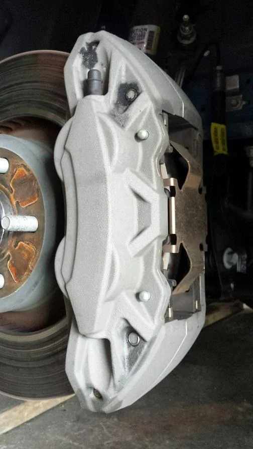

Here is a pic of the caliper after one 30 min session at road america. It appears that fluid seeped from the 4 bolt holes. Both calipers showed this. I have never seen this before with either my 911 or my 944 Turbo, both of which get pushed HARD at the track. Yes, a better pad might result in less heat transfer to the caliper, but the caliper shouldn't be weeping fluid out of every orifice. This does not inspire confidence in the manufacture, or design of this caliper. I do feel better having a "genuine" Brembo caliper up front. And when you push that pedal going in to turn 1 at Road America, at roughly 130 mph, you need confidence!
That is certainly concerning and very odd.
