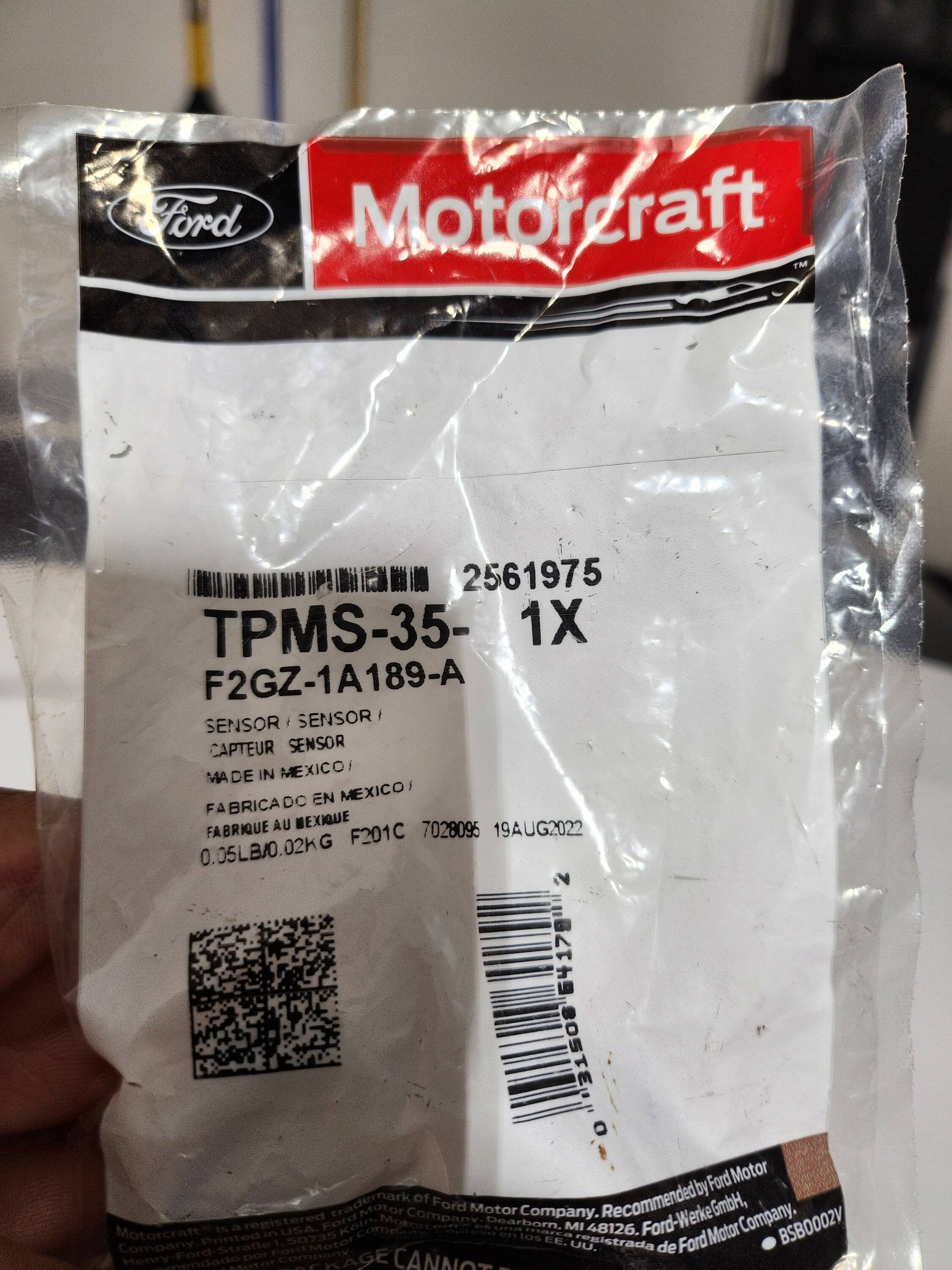

I had a similar issue with new wheels and tires; first sensor was broken and after installing a second sensor it still didn't work. If you haven't resolved the issue, it could be a sensor with an incorrect frequency. Ford parts gave me the wrong sensor. There are 2 different versions, both have different frequencies. The version in the picture below is OEM, and once installed, tire pressure readings worked again. FYI, price is approx $80 each.

Cool thanks for including the part number. Yeah I bought the set of 4 from LMR, the 2 in the rear work no problem. 2 in the front dont. So Im leaning towards they broke them.
