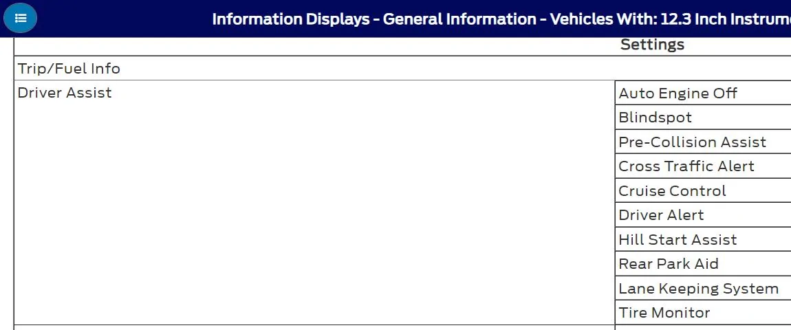

What do you have under the bottom setting :
That screenshot is from :

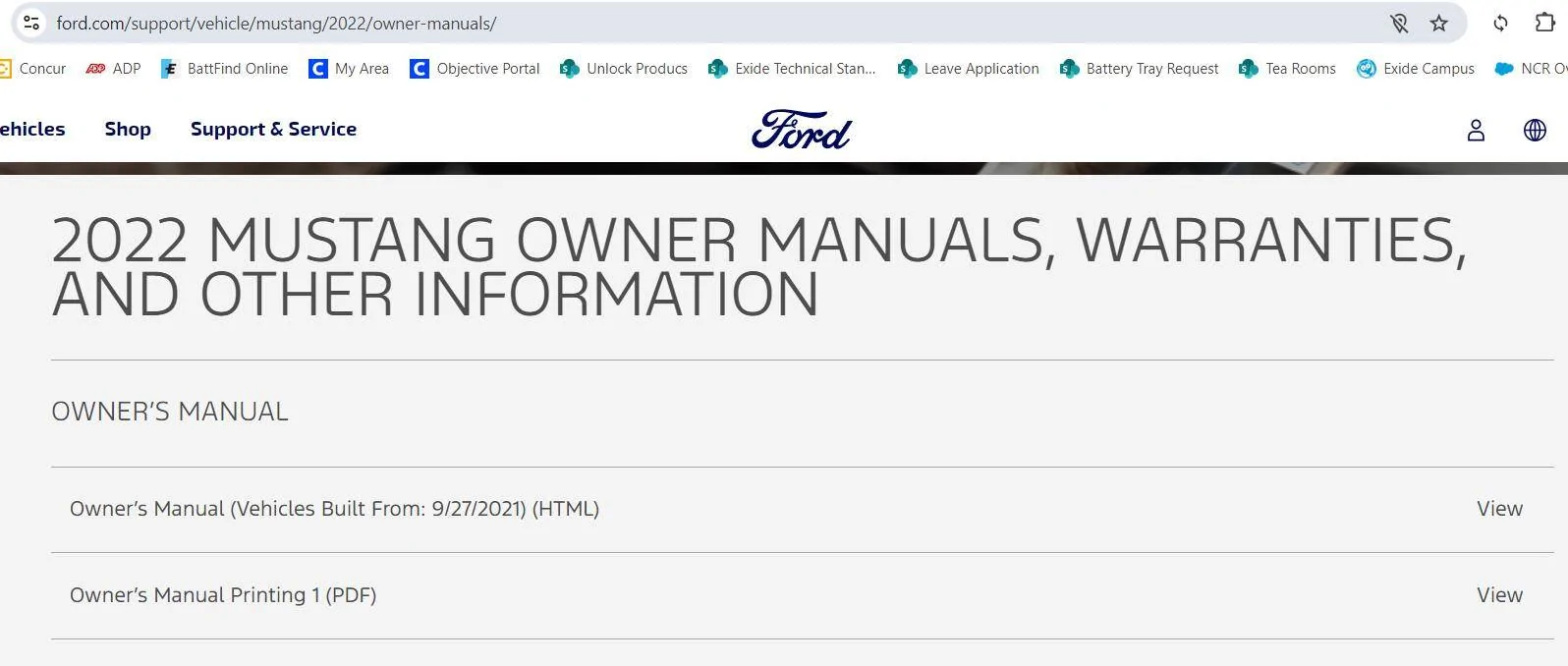

So...I went down the rabbit hole this morning. LOL. 🐰🐰🐰🐰🐰
A long read follows, but provides many references on this topic.
I'm left with the impression that, the actual TPMS set point is not programmable, cannot be changed, by the Owner/Operator by pressing a button or using in-dash menus. There is the possibility the set point could be changed by the Dealer or when using FORScan. The reset button or in-dash menu re-learns where the wheel is, and re-checks pressure of each wheel.
Ultimately, it goes back to the placard, vehicle wheel, tire and towing safety. The manufacturer sells a vehicle of a prescribed standard and specification. Deviating from that, or having the ability to, changes all kinds of things. The simplest and safest process, through several years and owners, is to fix the car to a standard, then list that in the door jamb.
You're right, I did see that. But when I attempted to learn what it actually does, this is what I found:
