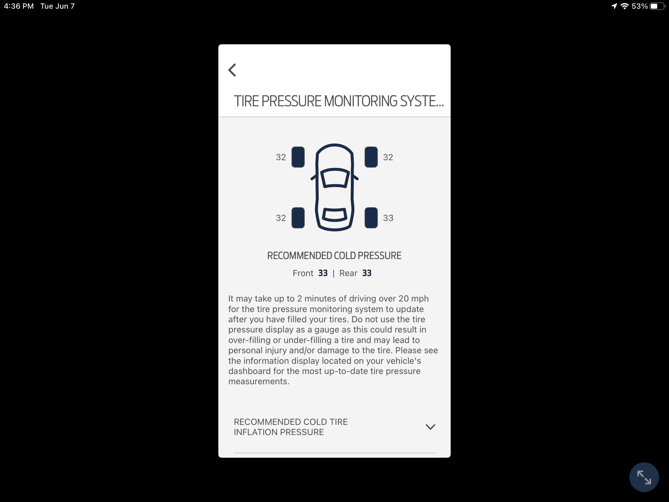

Thanks Dragoon. The info from the Ford App is very helpful.
And bummer. It means that I can't use the on-board tire pressure gauge as a tire pressure gauge. Who'd a thunk it. Guess I'm stuck with the old fashioned pocket gauge for another few years.

I don't think there's any vehicle where an owner can fill a cold tire and then check the PSI via the TPMS readings in the dash.
Many TPMS sensors won't adjust only based on adding (or removing) air from a tire in the driveway. Usually as noted above, the vehicle has to be driven so the TPMS can recalibrate based on internal tire psi which is also based on expansion due to heat.
Tire PSI shouid always be checked COLD, meaning before driving anywhere. Tire fill cold and check PSI is close to or matches the driver side tire label inflation specs.
When driving, the TPMS readout will adjust accordingly. Also to note, even though the tire was filled cold and met the label spec, be aware that tire psi will increase approximately 2-3psi once driving as the tire heats up. If you had filled all (4) tires when cold to the applicable PSI on the label, expect all (4) to read at least 2-3psi higher once warmed up. This is completely normal and there is NO reason to deflate the tire back down to the tire label spec IF it's reading higher when warm.
