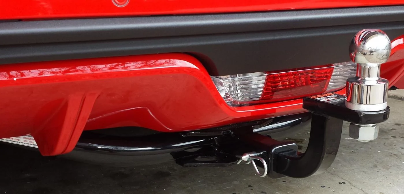

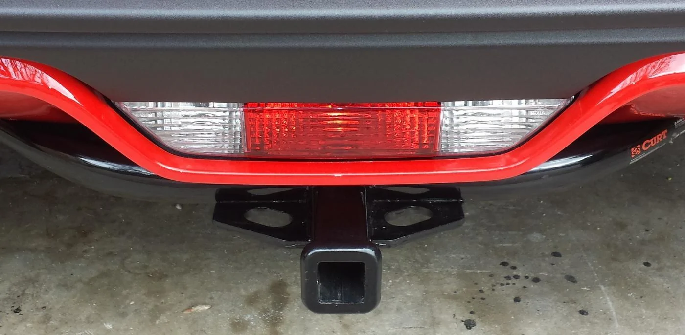

Gents - I have a Curt tow bar on my 2016 Mustang 5L Auto, Curt complies with US standard SAEJ684 and Aust ADR62/02 is almost a photocopy of the US standard. Cost around A$700 to get to Canberra and another $200 to be Engineered and another $65 for ACT Rego to inspect. Passed ok and Insurance company happy. Do not get the USA ECU as it does not fit the Aust connections and used the brake lights as turn signals also no reverse light, I got an Aust general use one from the 4WD shop and wired it into the loom. No problems after 4 months use. Cops had a look at it as well and were happy (they just wanted to stickybeak at the car and commented on tow bar)
I need a tow bar, but was concerned what it may look like, can you post a couple of photo's please? Much appreciated. Will save having to convince the other half she needs a tow car!

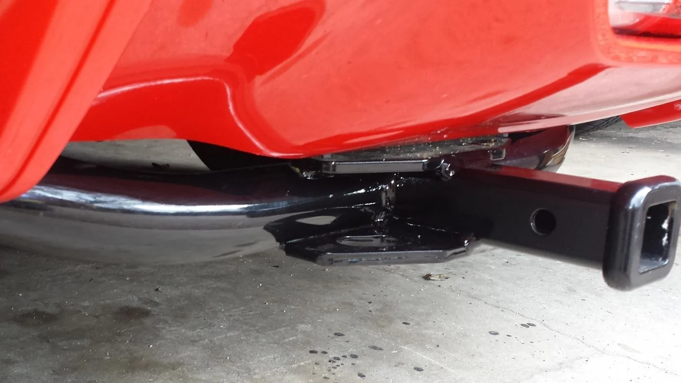

Had any issues with scraping? Looks a lot lower?

The lowest part hangs 6cm below the rear diffuser, never scraped it when reversing over average size gutter and cannot feel any difference in road handling when cornering. The front spoiler hangs a lot lower than the rear diffuser but generally I reverse into gutter 90 degree parking spots.
