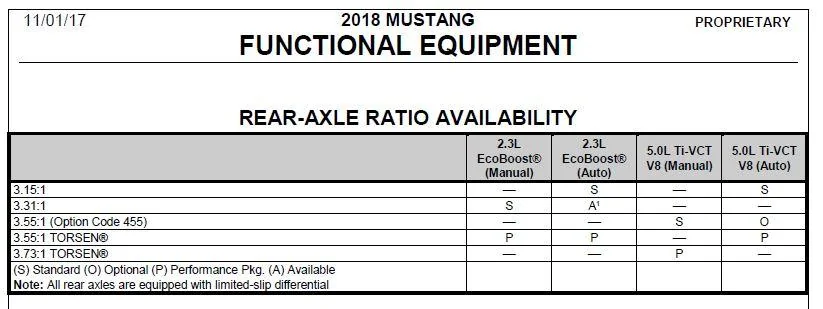

Per the 2018 Mustang order guide only PP cars get Torsen diffs. The 3.55 optional 3.55 does not get a Torsen. I have no idea which diffs get the iron housing other than my 15 GTPP manual and my 18 GTPP automatic both had/have iron diffs.
Edit: The 2019 order guide is the same in regard to the Torsen.

So it's a Trac-Lok then?
I didn't think they even bothered to put those in the iron housings with 3.55 gears.

I guess it's Trac-Lok then, because I looked at other models that have the Torsen listen in the options section, and when the Torsen is there, they always say "3.55:1 TORSEN Limited Slip Differential."
So, I guess if it says just "Limited Slip", then it must be just the regular Trac-Lok
