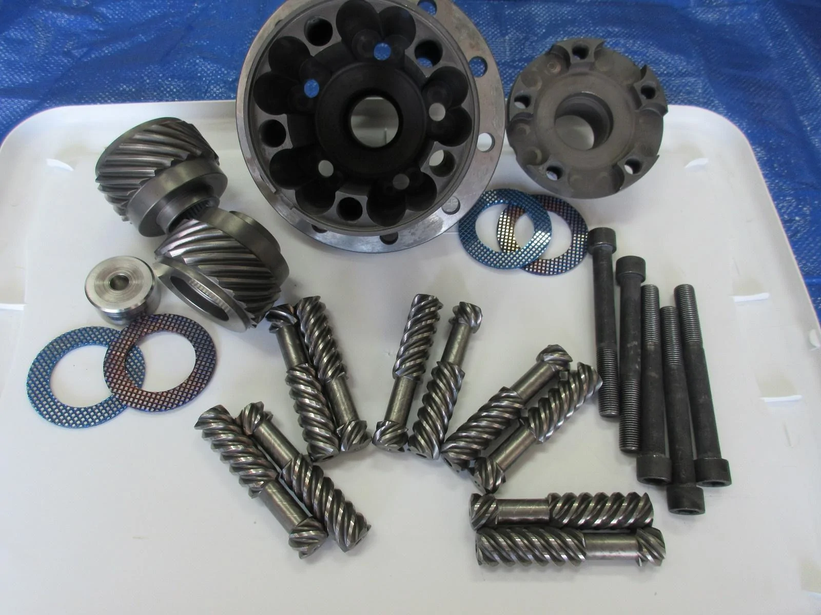

To clear-up a little misconception about the Torsen' Diff , here are some facts.
The video in the post above, and actually the one found on the Torsen' web-site, "Torsen Differential How It Works ?", is referencing a Type 1 Torsen'. In the Type 1 Torsen', the spiral gears run perpendicular to the axle, In the Type 2 Torsen', the spiral gears run parallel with the axle.
Ford uses a Torsen', type 2 (T-2R) in it's Mustang PP, and Shelby GT350 2015 & up vehicles.
This T-2R Torsen' unit is code-named: ‘Peregrine’. It really is built to last a lifetime as there are no service parts available for it.
In the Ford Service manual it specifically states that the Torsen' is serviced as a unit.
Ford does not manufacture these diffs, they are made by a corporation named JTEKT.
The Torsen' registered trademark refers to the "Type/Design", (i.e. Brand Name) of differential it is.
There are really no 'gears banging against each other', within the Torsen'. The T-2R consists of 10 tightly coupled spiral gear shafts, with very, very little free play between them.
Concerning the fluid spec: JTEKT specifically leaves the gear-oil recommendation for the Torsen' up to the Car-Manufacturer, in this case Ford.
Ford recommends the Torsen' to use the same gear-oil spec as the Traction-Lok, including the friction modifier.
There are basically 24 parts to this T-2R Torsen Diff.
Here is a picture of one I recently had apart. I have had several of these apart (varying from 2k to 35k miles), and they all seem to have very little wear, and look almost new.
For more information on this unit see:
https://torsen.com/product/ford-super-8-8/
**NOTE: the 'Peregrine' shown at the web-site state that it has 6 planet gear sets, all the ones I have had apart have 5 planet gear sets (10 planet gears in total).
