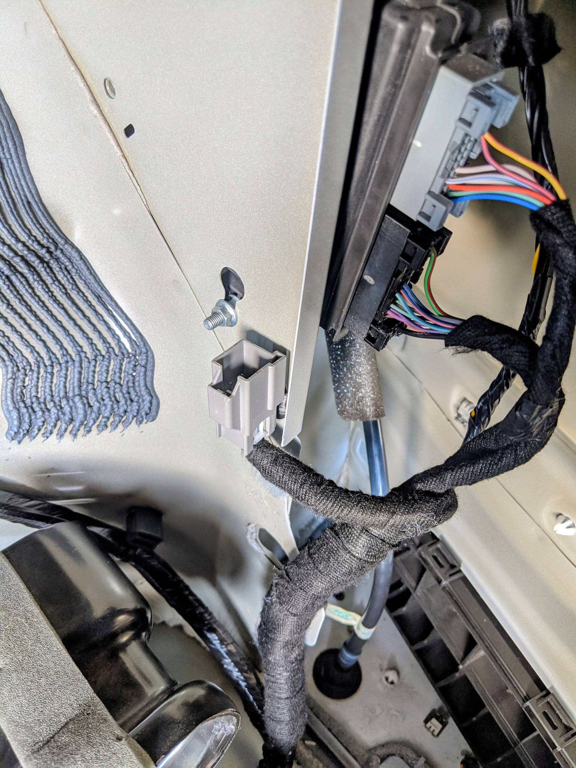

There are hoses on either side of the top well - they discharge to behind the rear wheel on either side. I don't know how to clean them - they look like the top part would be a nightmare to access.
Apologies for the poor photo, but you can see the hose behind the wiring.

My apologies, I thought that the photo may be self explanatory as I said it was behind the rear wheel.
I noticed the hoses when I pulled the trunk liner out to fit the subwoofer - that photo is the floorplan. You would have to access them from underneath the car.
I have absolutely no idea how you could access them from above, but I could see using an inspection mirror that they went up to the top well - I've also confirmed that coupes don't have the hoses, so that's definitely what they are for.

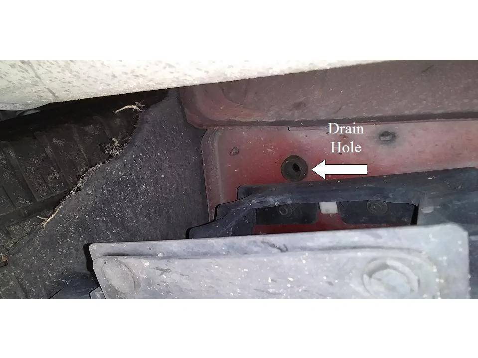

I found the end of the drain hose under the car ...
It's located just behind the rear wheel. If I find the other end of the tube I'll post it as well.

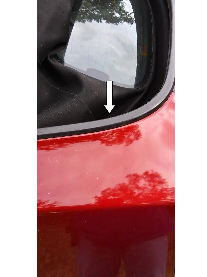

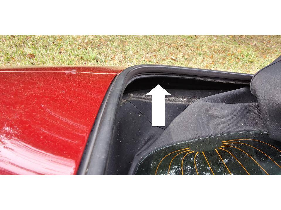

So I found the top of the rear drain holes around the base of the top. You can't see it, you have to feel around the base of the canvas at the rear of the car. This is what the drain hole would look like if you could see it...
Here's where the drain is located. There's one drain on each side of the car...
I opened the top about a 1/3 of the way so I could nose around the base of the top at the rear of the car. It makes it easier to access the drain ridge at the back of the top.
I haven't used air to clean out the drains yet. I've only gotten as far as locating them. Since I won't be able to get my air compressor fitting into the drain from the top I'll have to access it from under the car. I'll open the top 1/3 of the way again to give the top of the drains some room to allow any debris to be expelled a little easier.

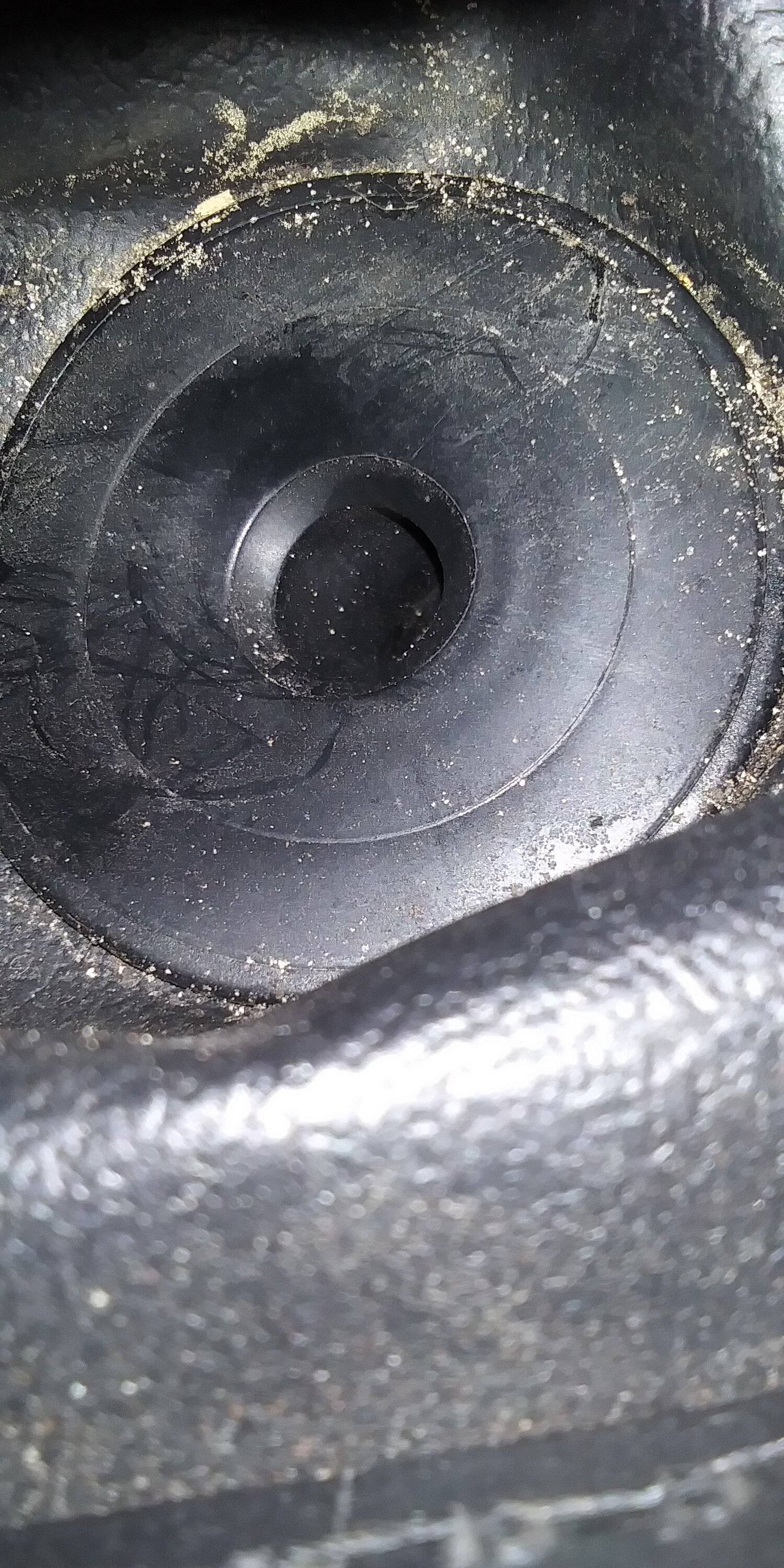

I was able to use my compressor with the correct fitting to blast air up from the bottom hole all the way up through the drain holes at the top. Fortunately there were no blocks or restrictions in my drains but I'm determined to keep it that way. I put the pics of the drains here to help others to keep their drain holes clean as well.
If you have a blockage in the drain you should be able to remove the trunk liner behind the fender and disconnect the rubber drain hose at both ends to clear it. It's a little awkward to get at but it shouldn't pose any great effort to remove. Food for thought.
