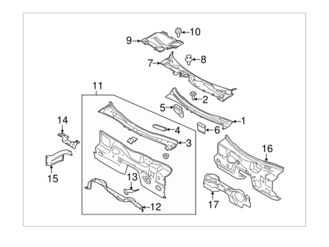

Well, I stumbled upon the "woke up to a foot of water in my car" posts late last night and now I'm freaked out. Can anyone tell me the location of the 18+ front cowl drain holes? Keeping them clean seems to avoid a lot of hassle later on. I read a lot about the "floppy rubber drains" in early 2000's cars, but nothing about newer models. I see a split in jacking crease about a foot forward of each rear wheel, which seems to be the same as earlier models, but missing info about the front drains. Edit: located this diagram. It seems I'd just remove the cowl grille (#7) then the cowl cover (#1) and the drain vents would be cleaned (#5/6). Thoughts?

Hey, do you know where this drain hole is? It seems that I need to clean mine out as well...
Look underneath near the front jacking point, about 6" behind the front wheel well. You'll see where the pinch weld splits for a half inch or so. Just big enough to stick a screwdriver in. That's your drain plug.

Great thanks! I was looking at the back near the rear wheel.
Man, I'm having a day. You're correct, they are in the rear. About six inches before the rear wheel. The front slopes towards the back but since the top (when down) allows leaves and gunk to fall down, the hole can easily become clogged. The plastic covers ford give are useless, since nobody is going to snap them into place every time they drop the top. Anyway, to clean it properly, the cover over the seatbelts should be pulled up and the hole cleaned from above using a long coat hanger or something. Since it's easy to get to from outside, shoving a flathead into the hole every few weeks is just fine.
Rockin'! That's an answer I've needed for a while!
When I do it, I'll post pics incase it can help others. Seems to be a common problem.

While these are older models, they've got the general idea. The pre 18's had terrible dash cowl drains that backed up and flooded the interior with water. This design has been improved for the newer convertibles, which is why I thought for a moment the drains were behind the front wheel wells too.
