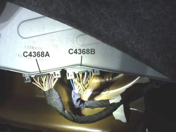

WEb Electric offers a module that adds one touch to the top. I have emailed them and they say the OTT-1M10 module will work for our cars. http://www.webelectricproducts.com/products.htm
This looks like a pain in the ass
Does not disable vehicle motion sensor
Installing the OTT-1M10 into your 2010+ Mustang

1) The connections are made to wires going to/from the Body Control Module (BCM) which is located in the trunk on the passenger side behind the insulation panel, near the right rear side marker lamp. During the installation procedure, make sure the power to the car is OFF and the key is NOT IN THE IGNITION. Make sure you have plenty of light so you can correctly identify the wire colors. NOTE: If you can't find the correct wire colors, DO NOT GUESS! Ask someone to help you identify them, or contact us at tech support. Incorrect hook-up can cause damage to your car!

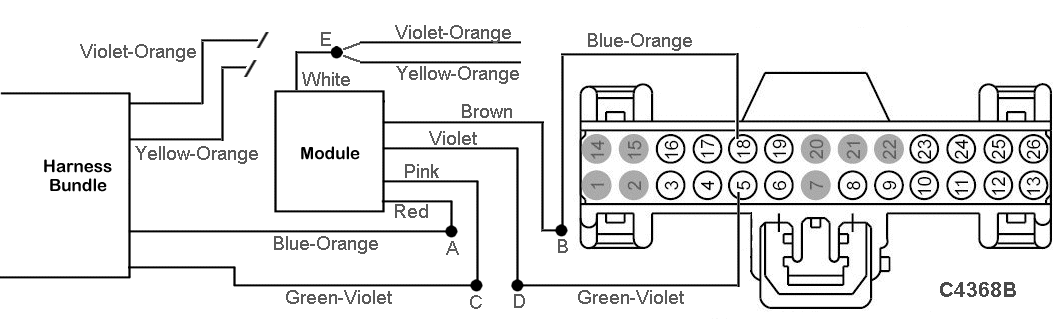

2) Unplug connector C4368B and unwrap it to expose the wires. Make the following connections:
A) Cut the BLUE-ORANGE (may be solid BLUE) harness wire about 2" from the connector and strip 1/2" of insulation from each end. Using a wire nut, connect the RED module wire to the BLUE-ORANGE wire coming out of the harness.
B) Connect the BROWN module wire to the BLUE-ORANGE wire that goes to the connector.
C) Cut the GREEN-VIOLET (may be solid GREEN) harness wire about 2" from the connector and strip 1/2" of insulation from each end. Using a wire nut, connect the PINK module wire to the GREEN-VIOLET wire coming out of the harness.
D) Connect the VIOLET module wire to the GREEN-VIOLET wire that goes to the connector.
E) Cut the VIOLET-ORANGE and YELLOW-ORANGE harness wires about 2" from the connector. Strip the CONNECTOR ENDS only. Connect both the VIOLET-ORANGE and YELLOW-ORANGE connector wires to the WHITE module wire.
F) Using TWO WIRE NUTS, cap off the harness ends of these wires SEPARATELY. Do not connect these wires to anything.

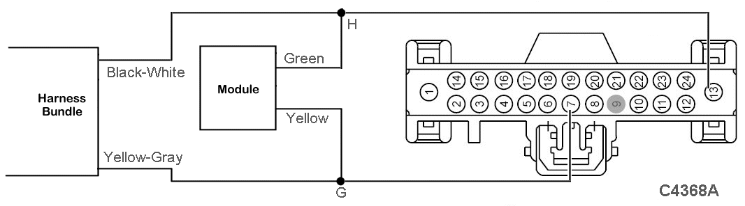

3) Unplug connector C4368A and unwrap it to expose the wires. Make the following connections:
G) Using a quick-splice, connect the YELLOW module wire to the YELLOW-GRAY wire coming out of the harness.
H) Using a quick-splice, connect the GREEN module wire to the BLACK-WHITE wire coming out of the harness.
Plug both connectors back in and make sure they are fully seated.
