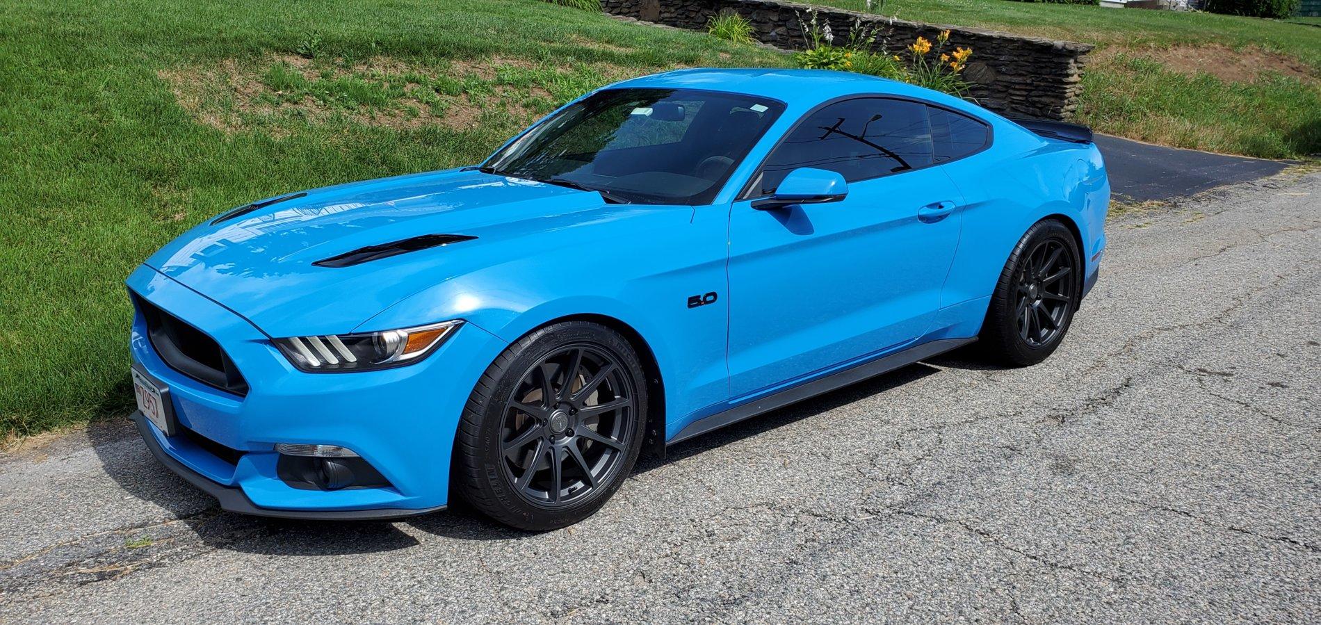

He's just giving you the tires, right, not the PP wheels? If so yes, the 255/40s will fit on a 9.5 inch wheel, and you could replace them with 275/40s when they wear out. Attached is what my 275/40 looks like on a 19x9.5 inch wheel. Something in the 35 offset range would work well for a square setup.
