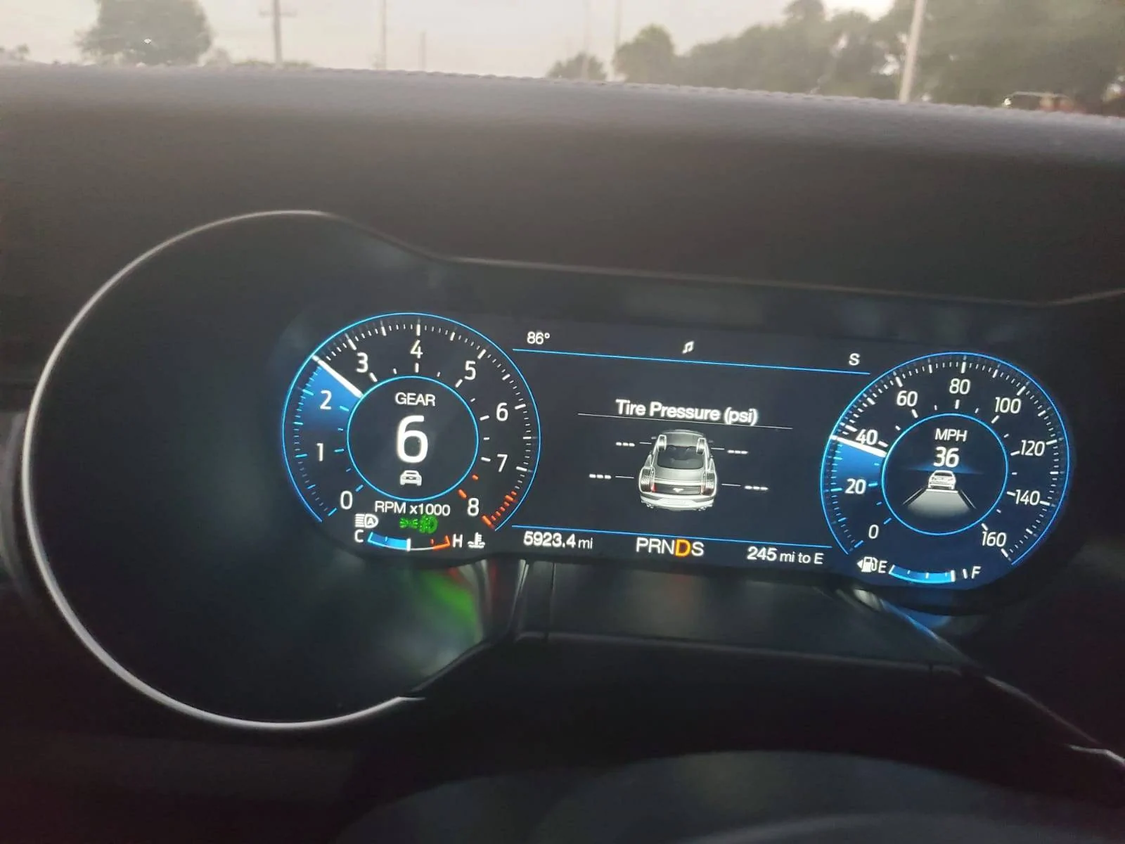

Anyone ever had this issue, yesterday morning the tire pressure reading was showing on the dash but later that day and this morning it stopped displaying it. Does anyone know how to reset them?

Have you checked manual.im guessing if you press some of the 4 arrow buttons around the select button itll show up.i know it does for battery voltage

I tried all that and still nothing.

It should show readings after a cold start within a mile. If it doesn't, something might be wrong with the system, since it's all 4 corners. Do you have FORScan? Check for codes first. Good luck.

Moisture in the tire's I'm betting. You fill them with air or nitrogen?

Sometimes the car requires you to drive a certain amount (distance) before it gets good readings from the sensors.
I drove over 90 miles and still doesnt read the sensors.
Dont have ForScan but just order the OBD2 so I can hook up my laptop.

The car is only 5 months old plus I havent put air in the tires since i had it.
oH WELL didn't look at what year car you have. Sorry. Anyways, that's what warranty is for, bring it in.

Yeah, it looks like something there (probably the receiver) isn't working properly. I would expect a warning message, like "TPMS failure, check your tire pressure the old fashioned way!" rather than just a blank screen.

Exactly that's why its weird no warning and I'm able to turn off traction control off.

Just tried it and still no show
Disconnect the battery, wait 20 minutes, re-connect it.
If that doesn't fix it, take it to the dealership.
Don't fuck around with forscan and a laptop or anything like that. Just let them fix it.
