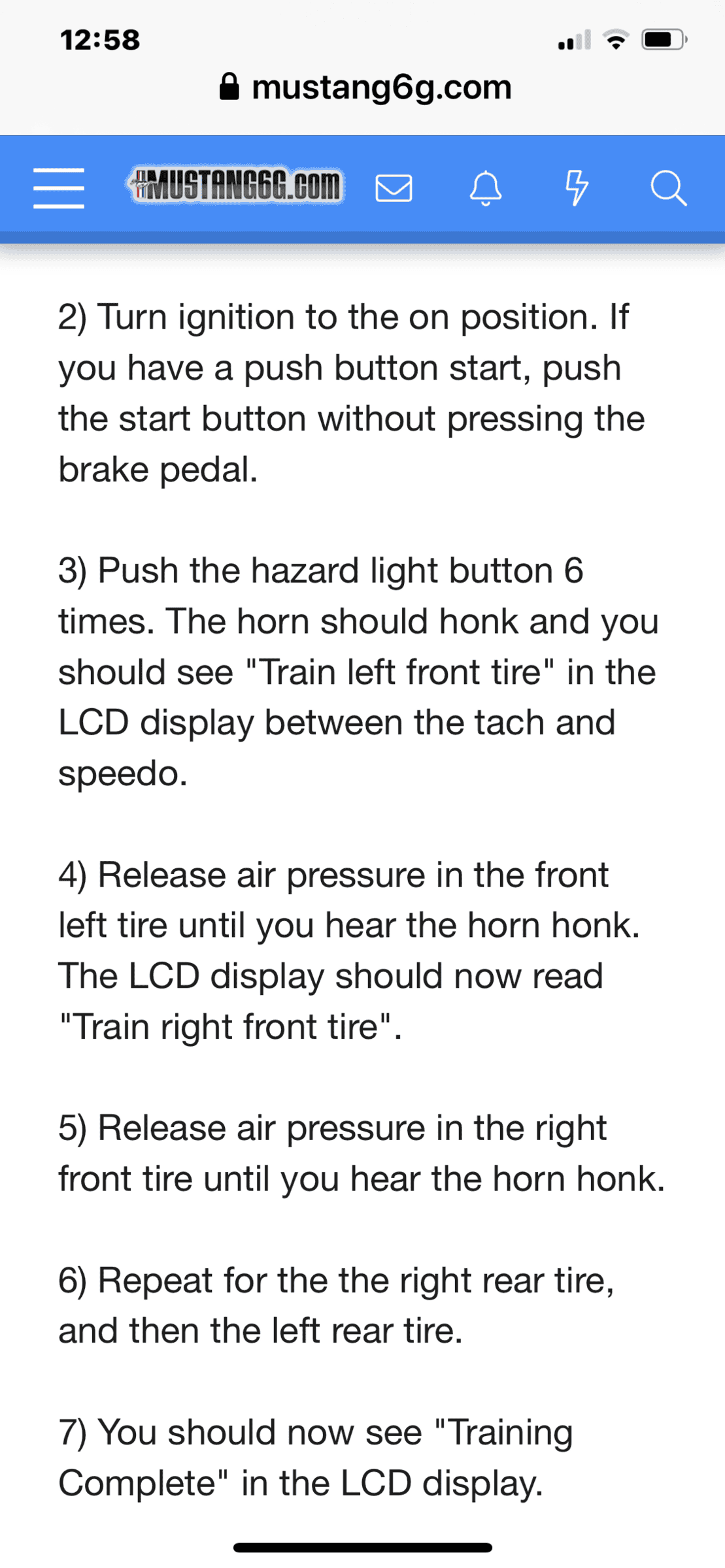

This works for me. It’s in a thread here somewhere but I took a pic for easy reference.
This happens to me when I air down and then air up again.
Good luck!

That’s supposed to happen, but I’ve found on occasion it doesn’t. When it doesn’t, I use the instructions above.
I air up the tires to about 40 then start the process. Then drop them where I want them after they’re all trained again.
Usually on the street I run about 24-26 unless I’m travelling and then I air them up. So my car goes long periods with the light on. Then when I do air them up the light occasionally stays on and doesn’t reset after driving a while. Then i retrain them and all is good again.
