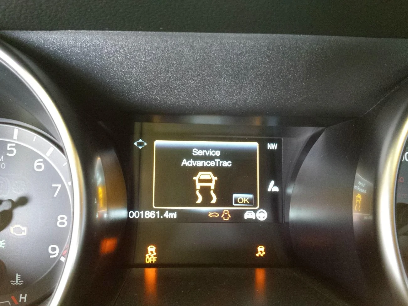

I think some people have had stability/traction control MIL issues on banked ovals. @Tomster?
More so in my old '16 track pack. The banks at Daytona would throw the whole stability augmentation system out as well as the traction control. Didn't happen hardly at all in the R
