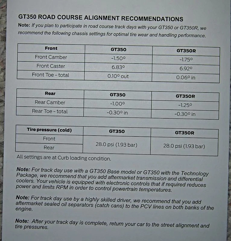

I am tracking my GT350 at Summit Point, West Virginia, this weekend. I've got 2,000 miles on my car. I just checked the tire pressure & all tires are at 36 psi. Door frame shows psi should be 32 psi. What is best for two days on the track?
