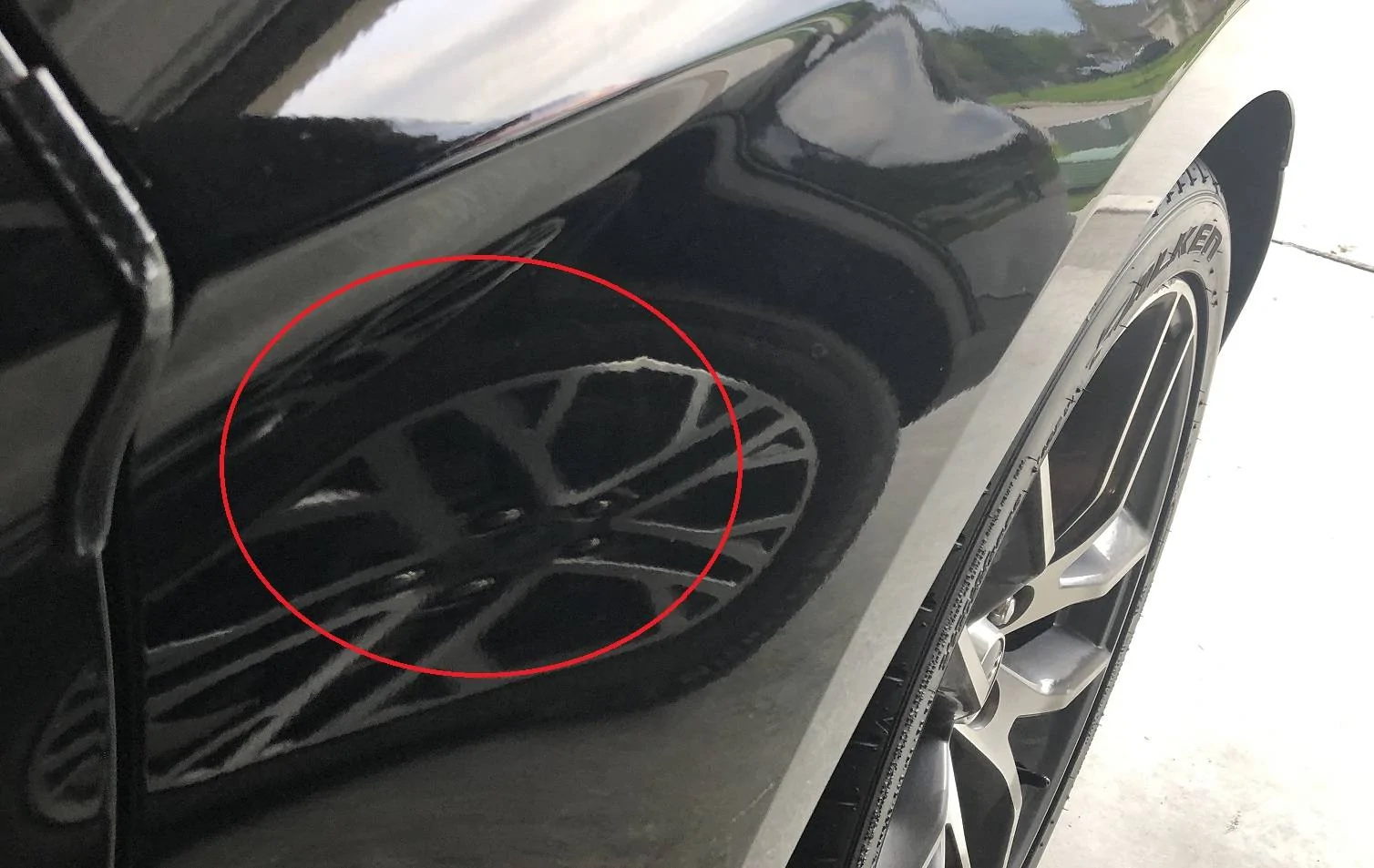

I have three tiny door dings on the driver's side rear fender between the door and wheel. They don't show up very good in the pic but the location is indicated by the red circle. The paint is OK but the metal is slightly dented. I have two questions:
1. If I remove the fender liner, is that area behind the dents accessible?
2. If it is accessible, is there a relatively simple for me to remove the dents?
I've used paintless dent repair to fix a larger dent in the front fender but I don't want to spend that kind of money for something that's only noticeable at a specific angle in certain light. I'd like to do it myself without the potential to making it worse if that's possible. If not, I'll just have to live with it. Any ideas would be greatly appreciated.

my PDL guy discounts down the more dings present, 1 is not worth it but if you report more dings, then the price gets better.
Not recommended to try to fix it from inside or mess with it, unless your a PDL pro.

Anyway, I wasn't planning on banging on it with a hammer. Maybe just gentle pressure from the inside to make them less noticeable. How to do that, I'm still trying to figure out. After the first of the year, I'll be pulling the wheels to rotate them and check the brake pads so I might pull the liner just to see if it's even accessible. If not, I'll probably not worry about it.

Pushing dents from inside are risky
Deleted member 35644
Guest
I can't say whether you have to take off the interior panel or if you can get to it from the fender liner, but I will say, don't do it. I tried this on my 2011 Kia Optima and made it worse. It's a skill that requires training.

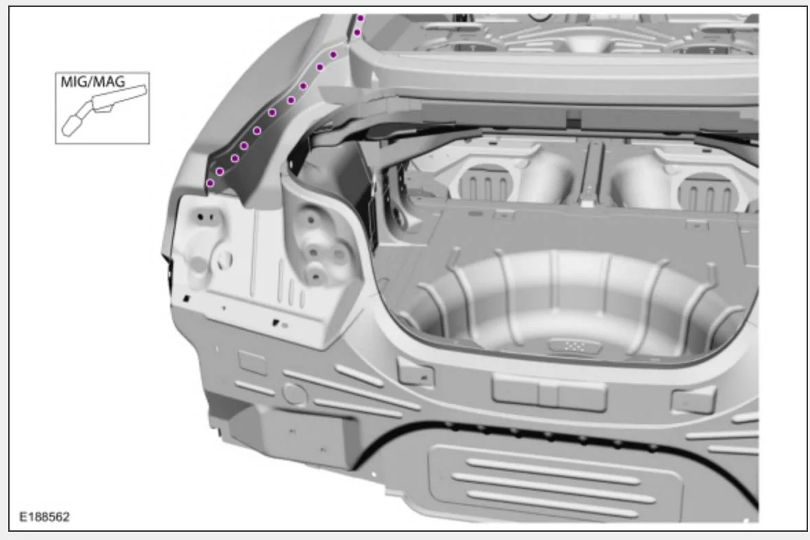

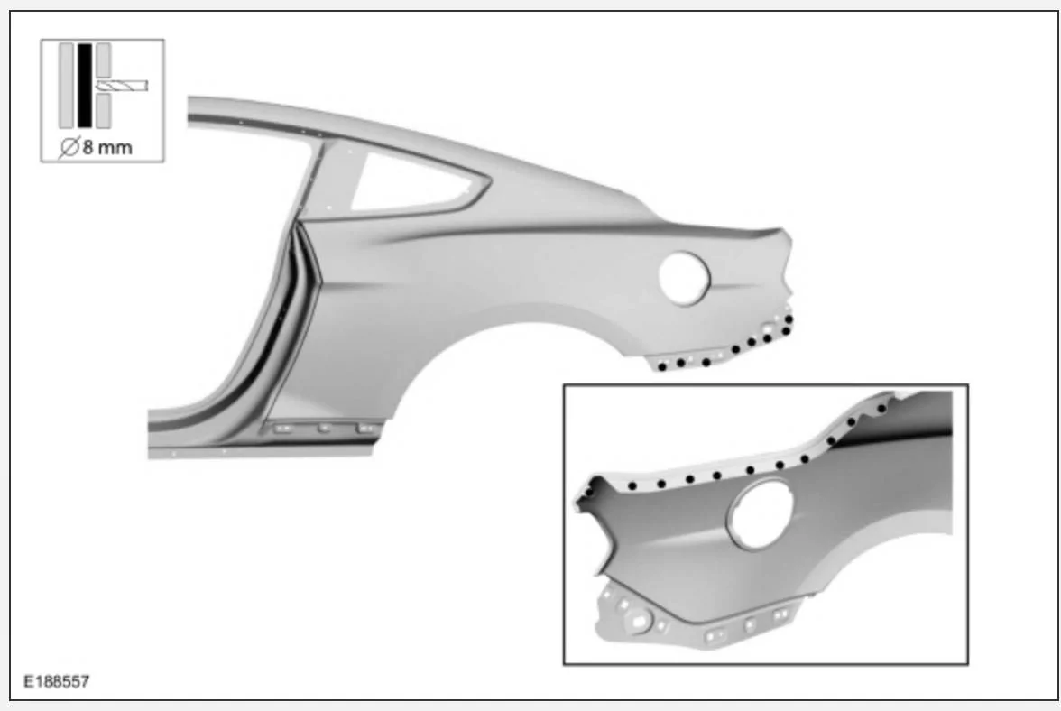

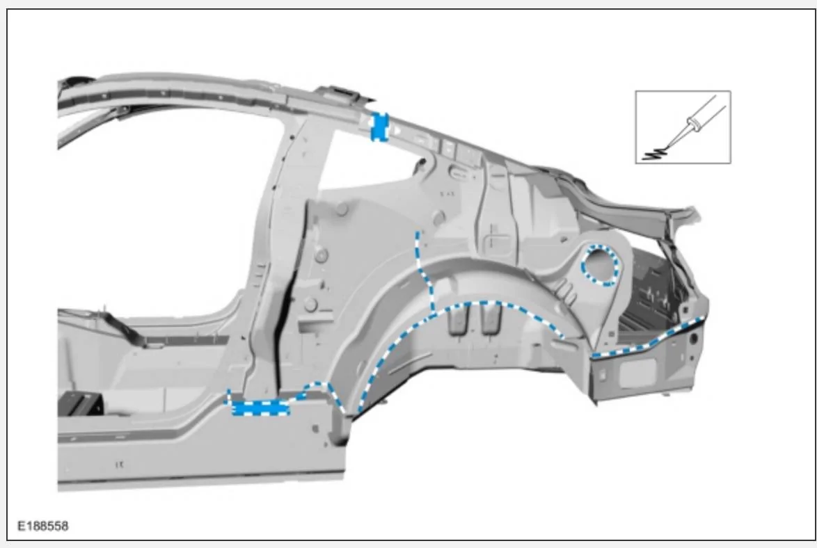

If the rear inner wheel well liners are removed I don't think there is easy access getting to back side of the 1/4 panel, you may be blocked by the inner wheel well housing.
The only way to PDR that would be coming in from the B-pillar (either through an existing access hole OR a PDR Pro or you would have to drill an access hole to use the tools). One might be able to get through some other access point within the trunk, rear tail or from behind the rear interior plastics.
These are the only images I could find that would demonstrate what I’m referring to above, based on your question about being able to access behind the rear 1/4 panel sheet metal.
