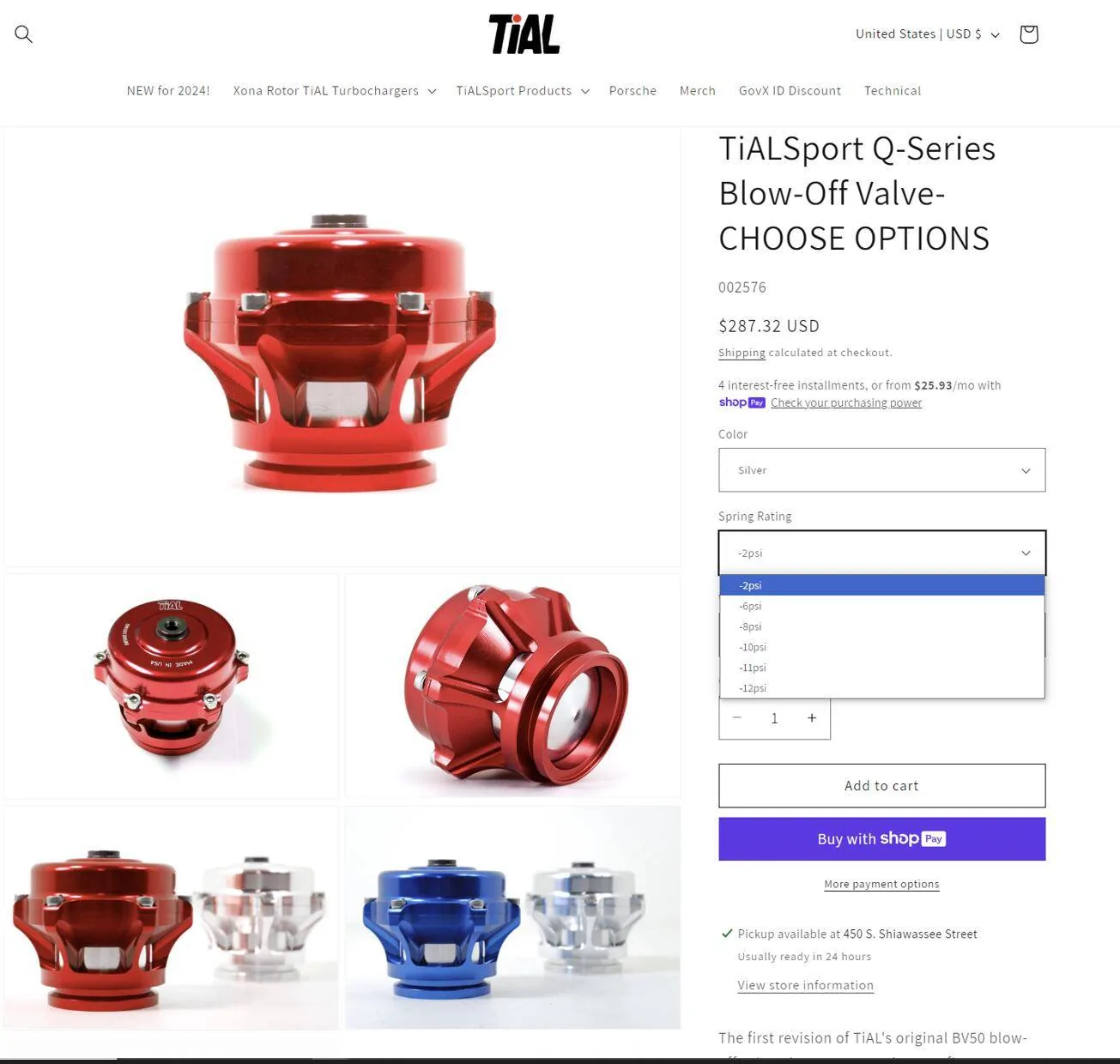

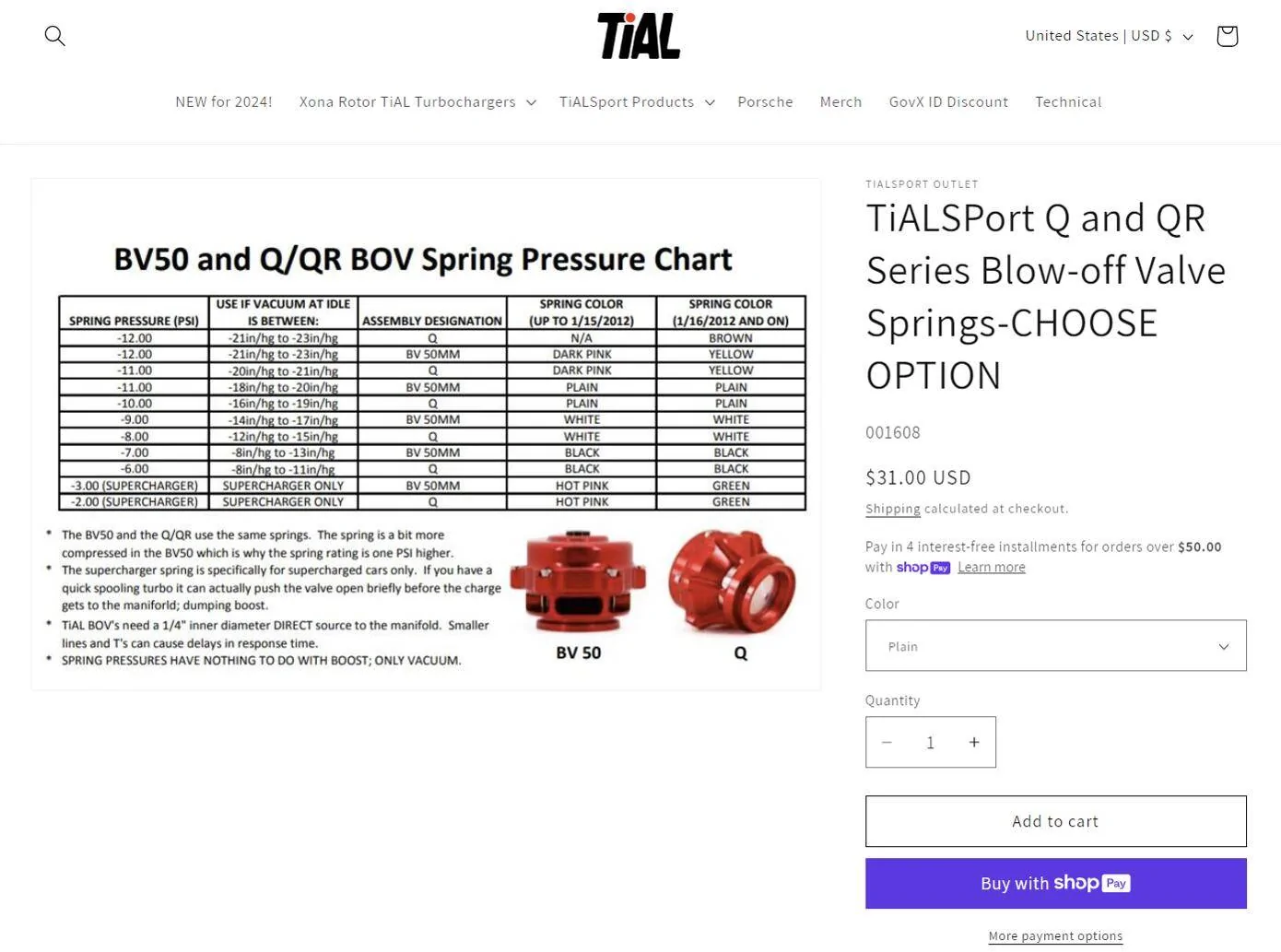

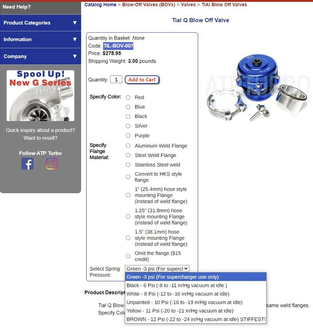

Hey all,
I just got and installed a Tial Q BOV (TIL-BOV-007) from ATPturbo. In their dropdown for selection of spring, they have a specific column for "supercharger". I have a Procharger supercharger. The spring size is "3 psi". Now, I have heard that everyone is saying to get a "2 psi". I recently (this morning) checked out the Tial website, and they only offer the "2 psi" for the supercharger application.
Has anyone else run into this, and is there a difference, other than what is stated on this chart?
Also, if you look at the chart, there are different spring sizes to choose from, if we are running a supercharger application, I assume we should ignore the "vacuum at idle" ratings to select a spring. At this point I'm a little confused......it seems to be working ok (as far as I can tell)......
Please chime in. Thanks!

Sounds fine to me, but if are you having any surge or if the box isn't staying open at idle you need a lighter spring.
No surging. And the box stayed open during that initial recodring. Seems to run the same as far as i can tell, just noisy as hell. Woooosh! Thanks for the reply!

Yes the 3psi spring is fine and like others have said it's working correctly.
