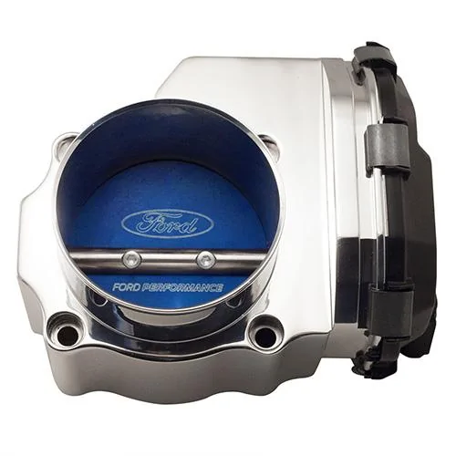

Just a quick question the Ecoboost Mustang gets a 60mm Throttle Body. Has anyone used a TB off the Focus RS as that has a 65mm TB, did you feel or did the car make any gains, but more importantly did it work ?
The reason I ask, Ford Performance offer a 70mm TB for the Ecoboost 2.3L Mustang motor, but Ford Performance are unable to confirm it works on the Focus RS 2.3L.
So my first question if the Focus RS TB works on the Mustang then the Ford Performance TB should work on the Focus RS I guess ...........................

Looks like the 70 MM does not need a tune to work from the Official Ford Performance website:
  • Fits 2015-17 Mustang 2.3L EcoBoost
  • 70 MM throttle replaces production 60 MM throttle body
  • Billet aluminum construction with polished exterior
  • Complete bolt on replacement fully compatible with the production air intake system
  • Includes new mounting bolts
  • No calibration changes are required
