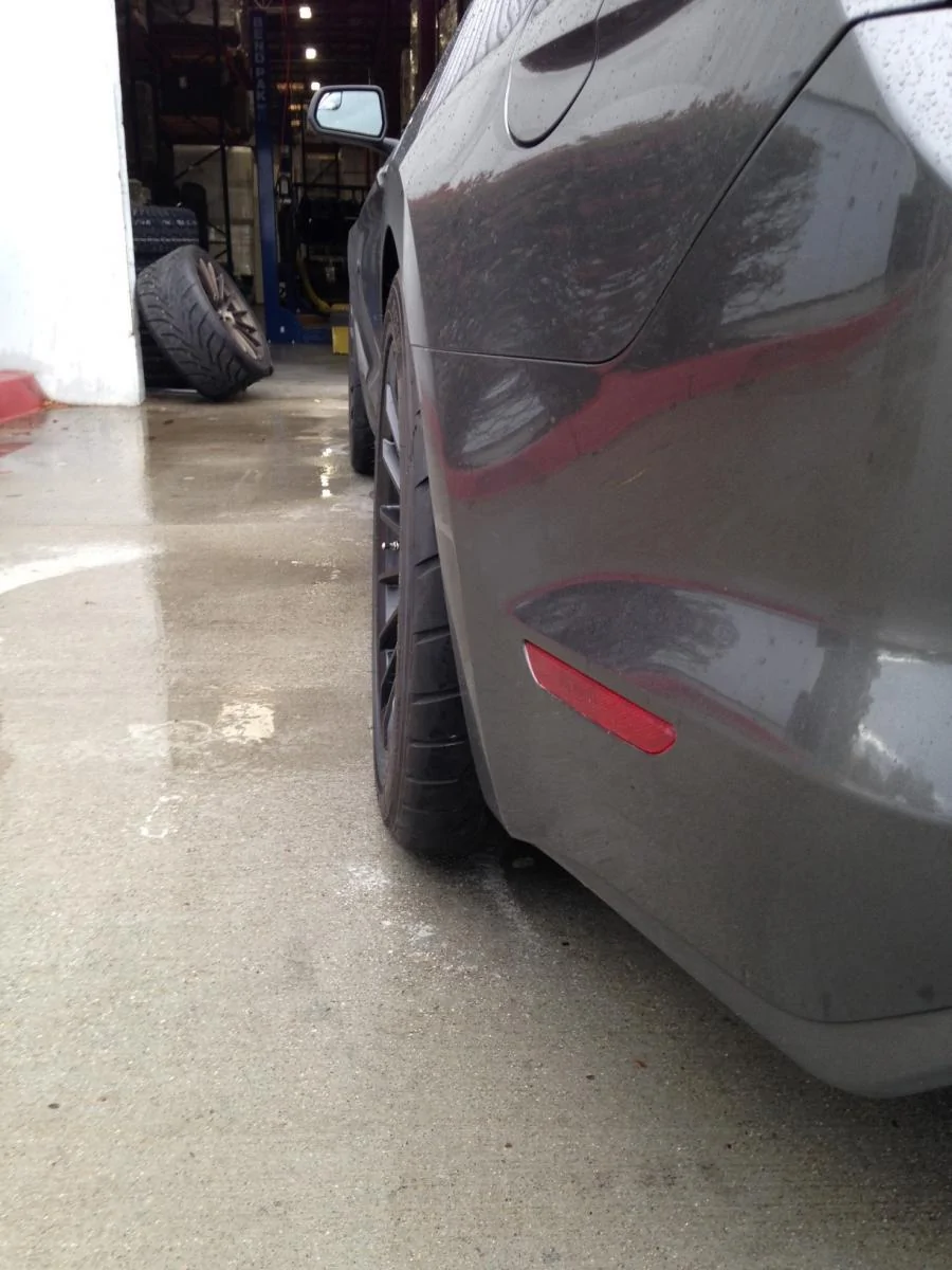

It sits very nice. We made this fitment specifically for the hardcore track guys and race teams. It does need either Cortex Coil overs up front (or similar) that relocate inboard farther, or longer studs and an approx 12mm spacer. Again, this is in reference for the front. the rear is plug and play.

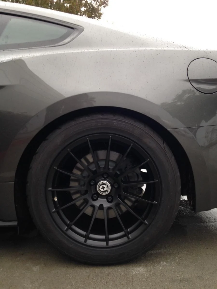

Here are a couple pics to show the rear fitment. This is with a 295/40 18 Nitto...

So 18x10.5 et 36 would fit all the way around, but be tucked more in the back?
What are your thoughts on 275 40 17 on 17x10.5 et 28?
It might be tight. I ran a bunch of comparisons and math on them and your setup with the mentioned spacers for the front is PRETTY close to the same fit to the sheet metal.
Based on the pics above, it looks like my 17" solution might work too, although it would be tight like a virgin. LOL
