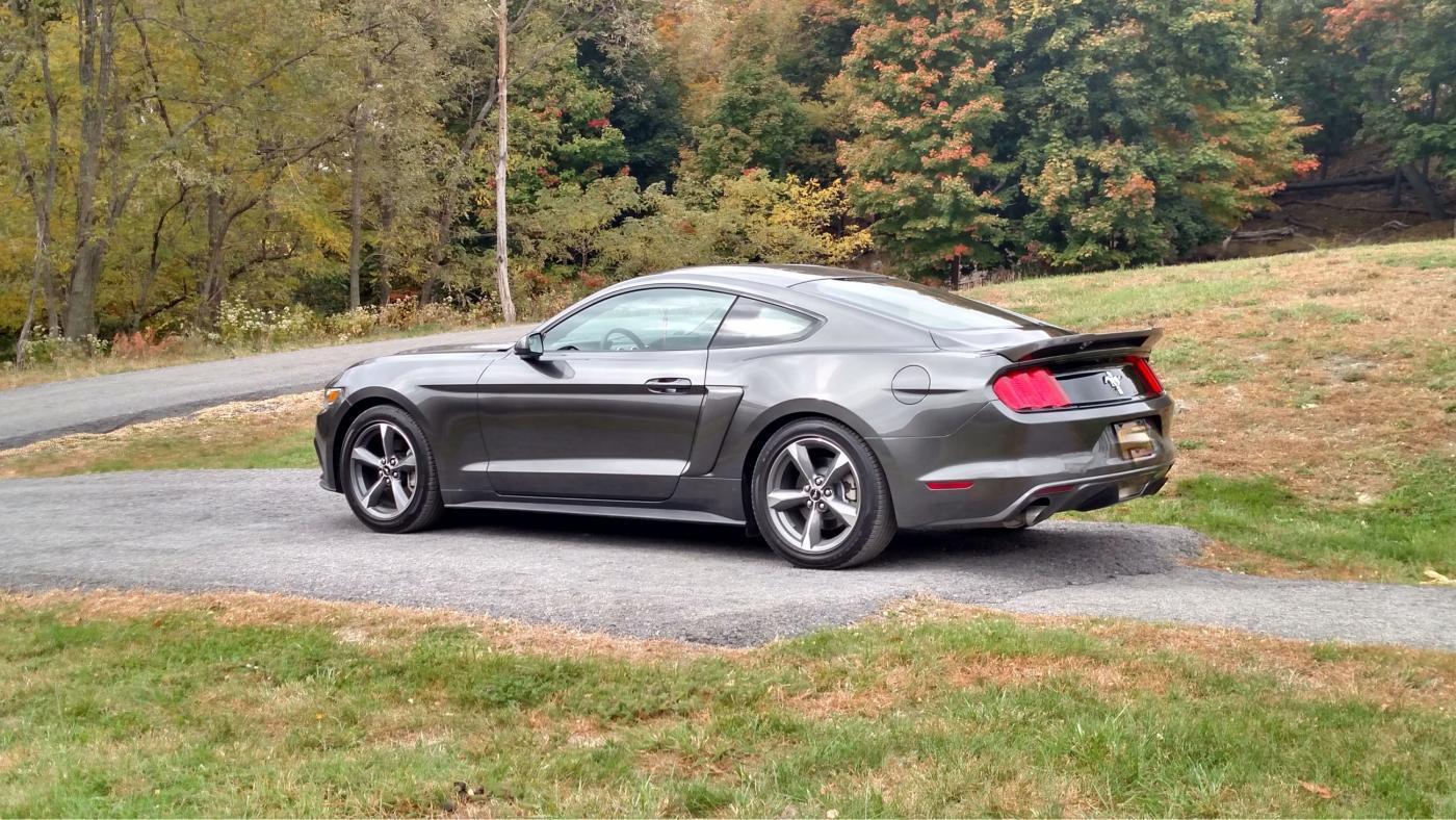

My 18 in Foundry wheels.. I love them! I want 17's for Snow Tires for next winter though..
