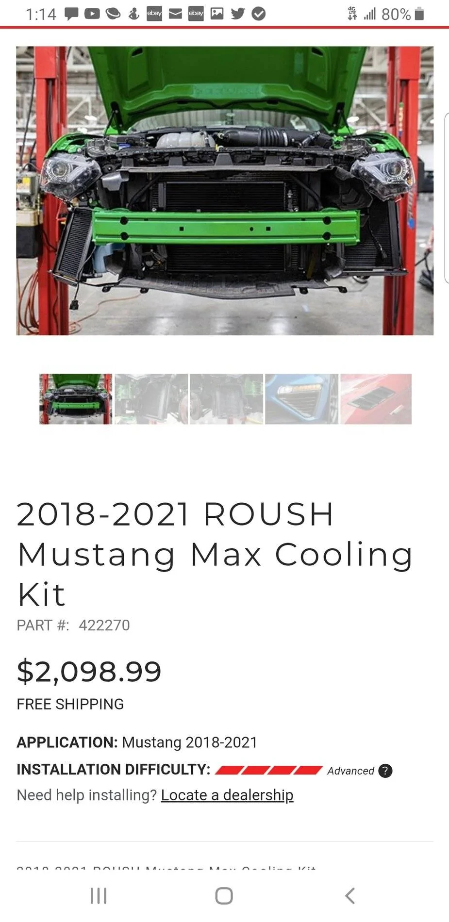

I understand the idea and principles behind this but not my cup of tea. I’d rather spend $1100 on a killer chiller and get way better iat2’s and use the left over money for other parts. Now if Roush could show consistent real world numbers at just above what the Killer chiller can do then it might be worth the money. I’m also not a real fan of chopping up my car either but that’s just me.

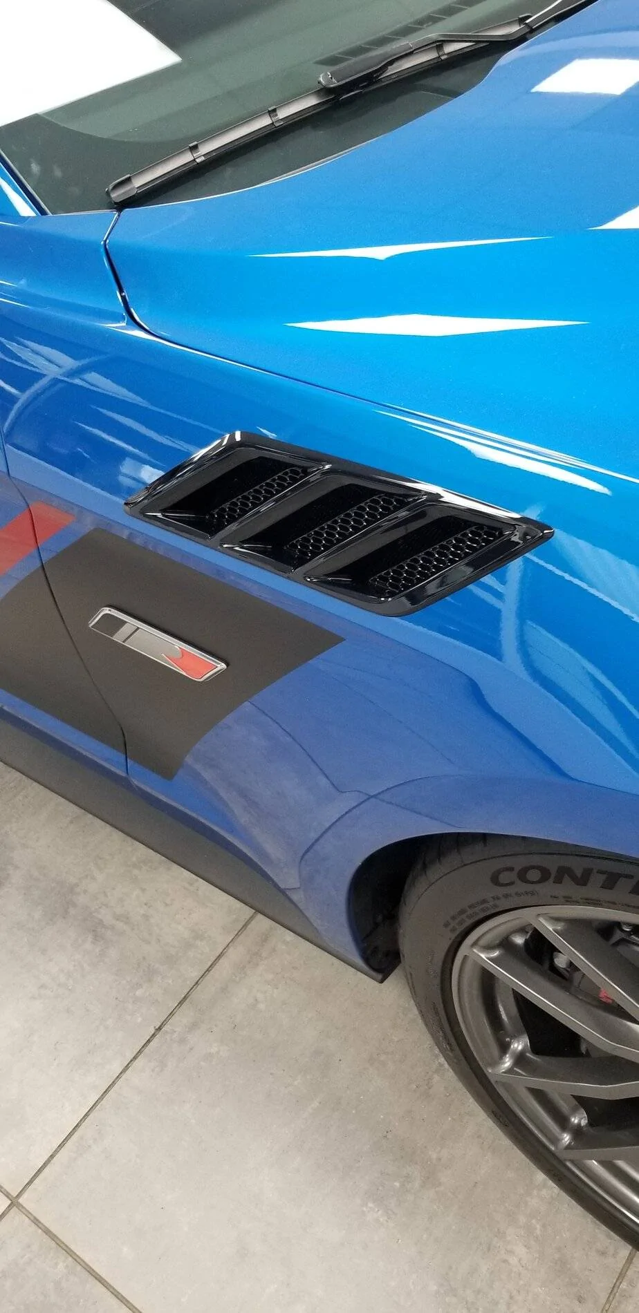

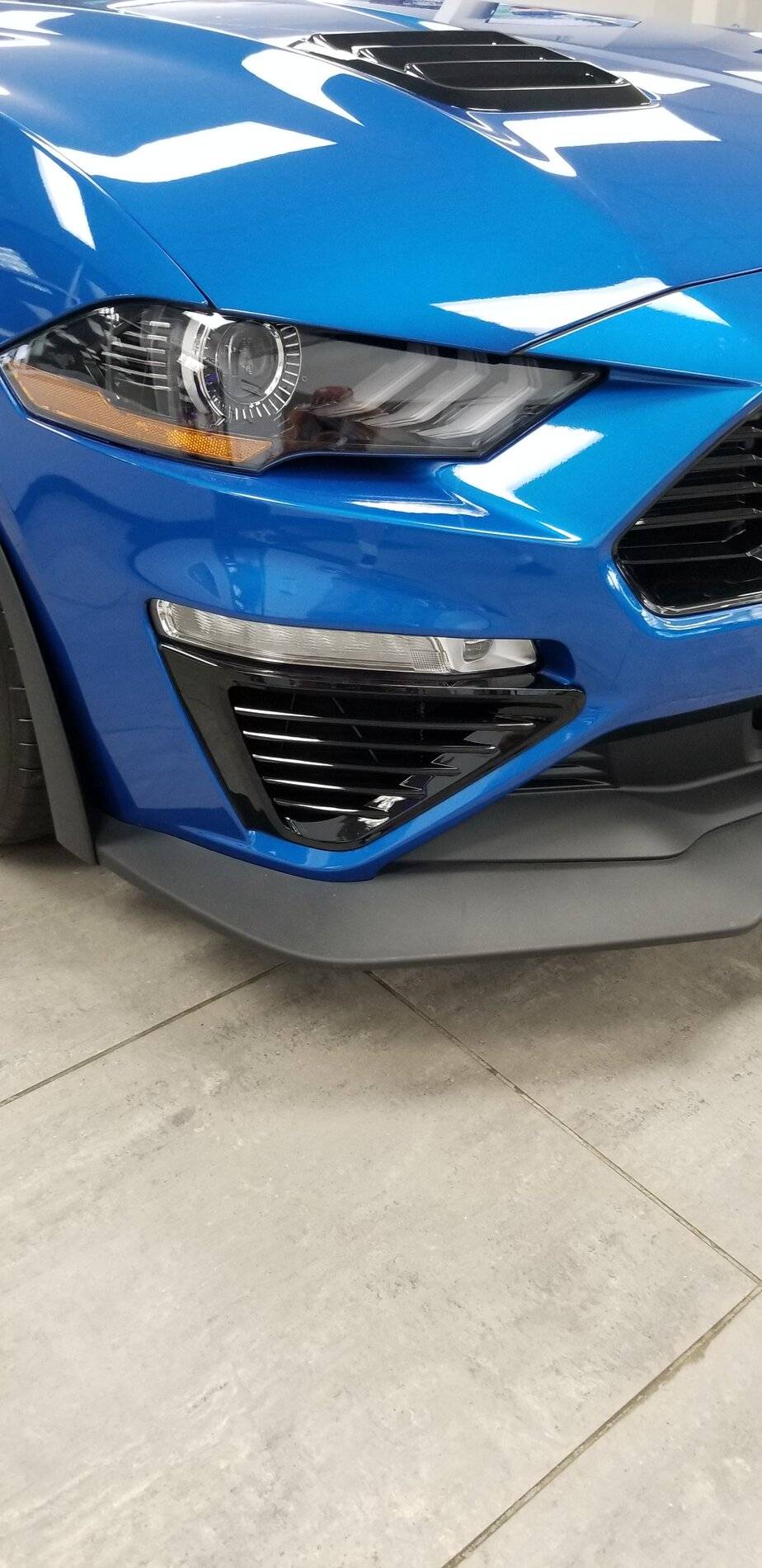

Thanks for the reply!!! =) what is a killer chiller? I've never heard of it. I'm new to S550S, I'm an oldschool foxbody guy, learning as I go along.
I agree with you via chopping up car. The kit does come w that those really cool side front fender vents that the stage 3 has.. they work hand and hand w front fascia vents to cool off auxiliary coolers.
