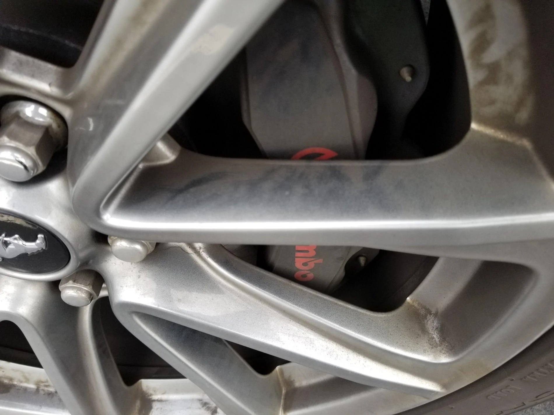

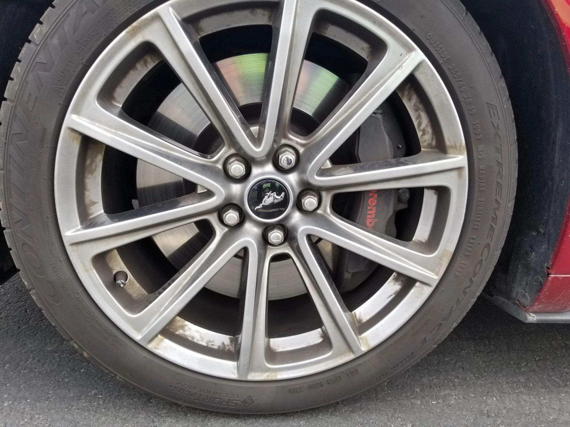

kz
Oct 26, 2014
4,594
2,920
West Chester, OH
Mustangs & F150
They absolutely do clear Brembos. I use them as my winter set up with DSW06 and have them on my car right now. If anyone wants the pic, let me know...

EFI
May 19, 2015
65
5,287
4,732
Masshole central
5.Br0
Please do, I'm also looking for an extra set of wheels and these are cheap and plentiful. Curious how close they really are.
BlownGP
BlownGP
Jan 25, 2016
1,161
317
Houston/Baton Rouge
Steven
Pontiac, Ford, Dodge
Well, thank you man!!!
