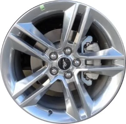

Does anyone know if the 19" Pony Package wheel will fit over the Brembo brakes on the '16 PP1? I'm putting together a square winter set up and this would be a good solution on a budget if it fits
https://www.hubcaphaven.com/p/24871/aly10161-ford-mustang-wheel-polished-jr3z-1007-m.html
Ford Mustang 2018-2020
Product Specifications:
Product ID: ALY10161
Product: Wheel/Rim (Single)
Material: Aluminum
Style: 10 Spoke
Finish: Polished
Lugs: 5
Bolt Pattern: 4.5 Inch
Offset: 42.5mm
Option Code: Pony Package
Indents: JR3J1007HA, JR3J1007HB
OE Part Number: JR3Z1007M

Check out this thread.
https://www.mustang6g.com/forums/th...stang-gt-pp1-or-pp2-for-wheel-fitment.132601/
I did a measurement on my PP2 Brembos and came to the same numbers for barrel. The consensus is that these aftermarket are identical to what Ford sells.
Send this template to the manufacturer and they will be able to tell if it will fit or not.
My barrel measurements are listed there as well. Template is in first post.
