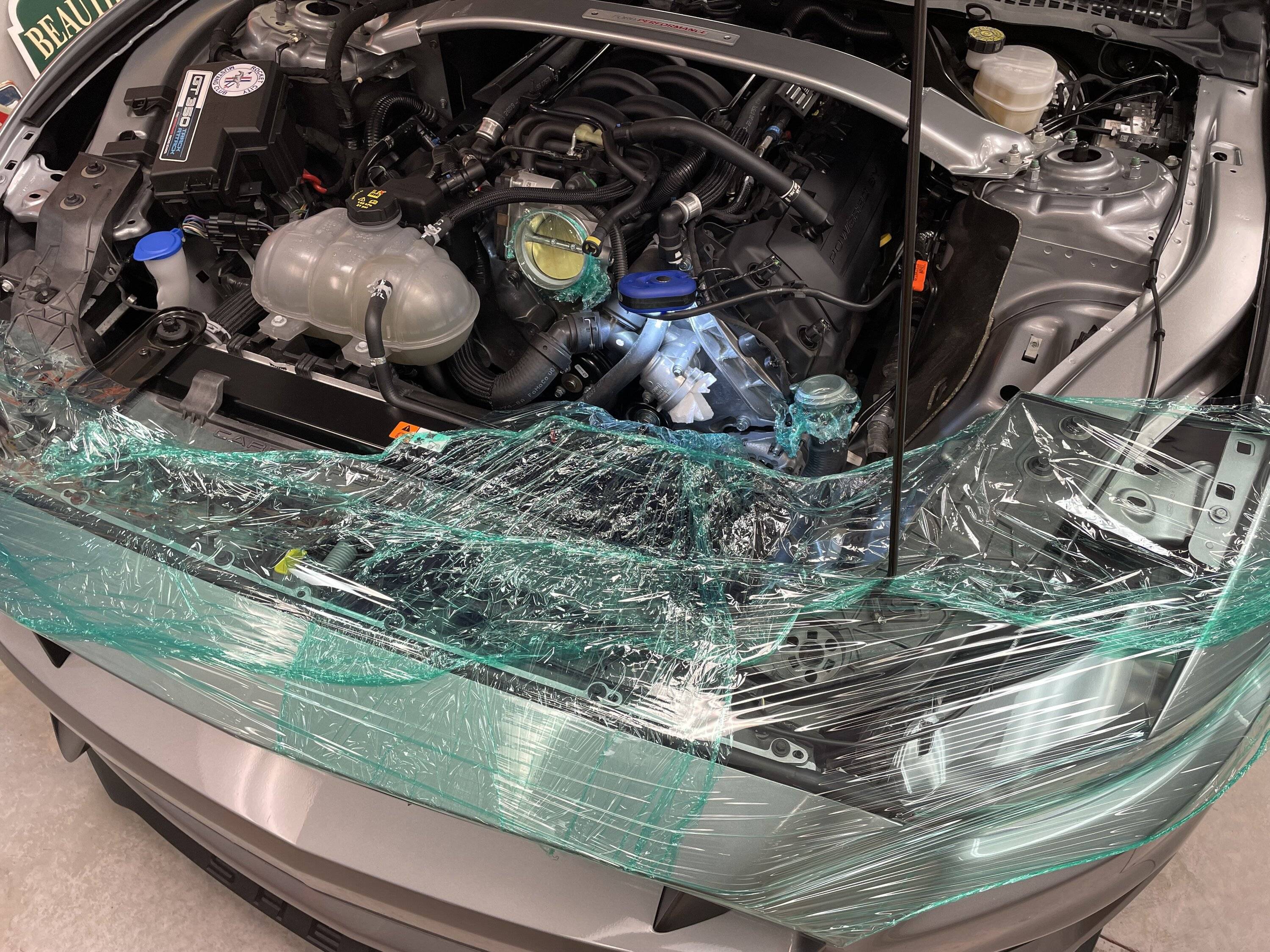

After some research it appears my thermostat is stuck in the open position. I started the disassembly last night - air box and air intake tube. super simple and easy removal. With these out of the way it seems it will be pretty simple to remove the two bolts that hold the thermostat housing together and allow removal and replacement of the thermostat and thermostat O-ring seal. Containment of the coolant seems like the major hurdle.

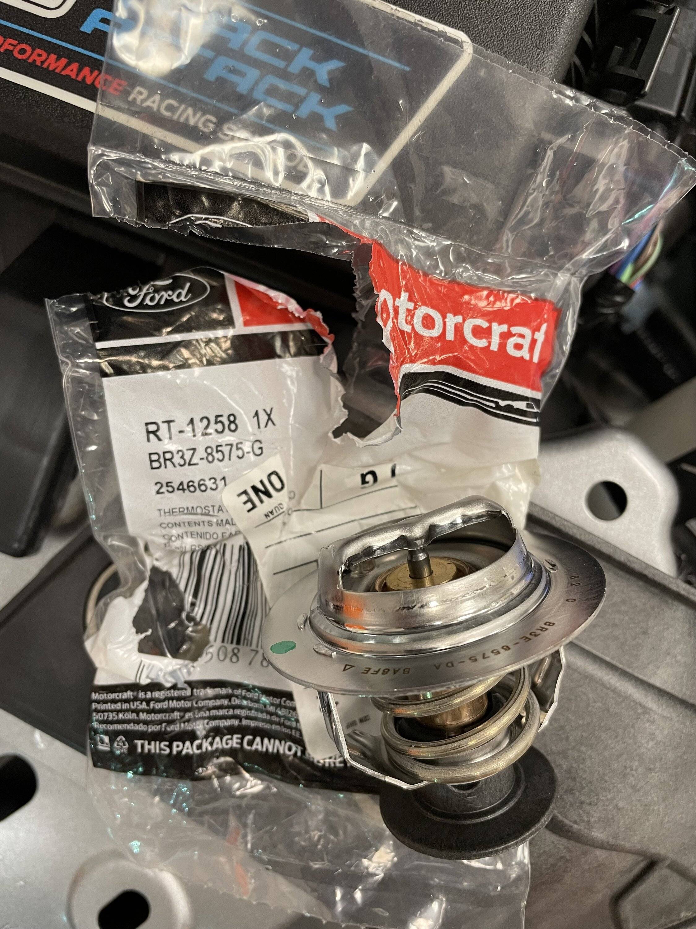

Unfortunately things didn't go as planned. The package had the correct part number but the thermostat inside was the wrong thermostat. Just picked up the correct one and plan to install tonight. I'll try to post an update once complete. The scary part is that the wrong part number thermostat fit but had a much smaller opening so it would have drastically restricted the coolant flow. I just double checked part numbers to be sure and realized it didn't match and then realized the opening was much smaller. Basically looked the same otherwise as most thermostats do. Lesson learned - open parts at the dealership and check the part number on the part.

Correct thermostat installed, check engine code cleared, and everything back in working order.

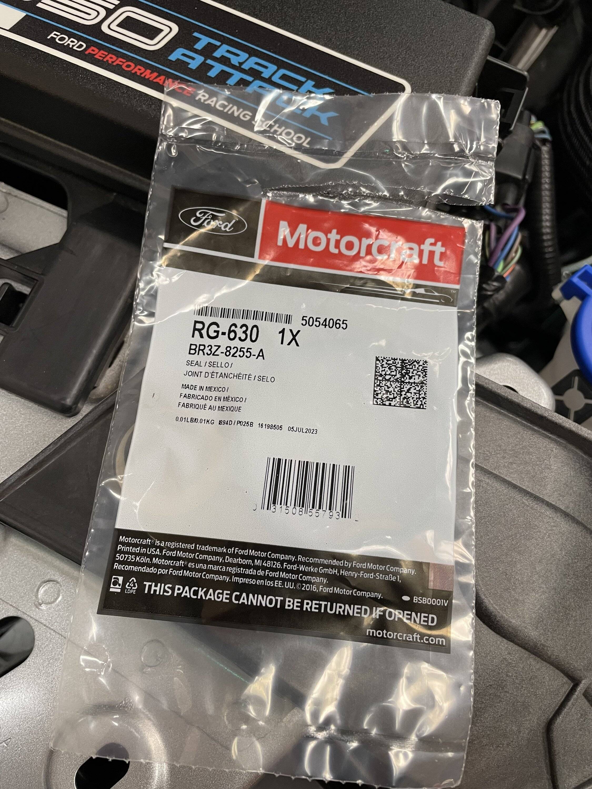

The replacement thermostat is a little different design but it is the same size.
Here are the part numbers for the thermostat and the o-ring.

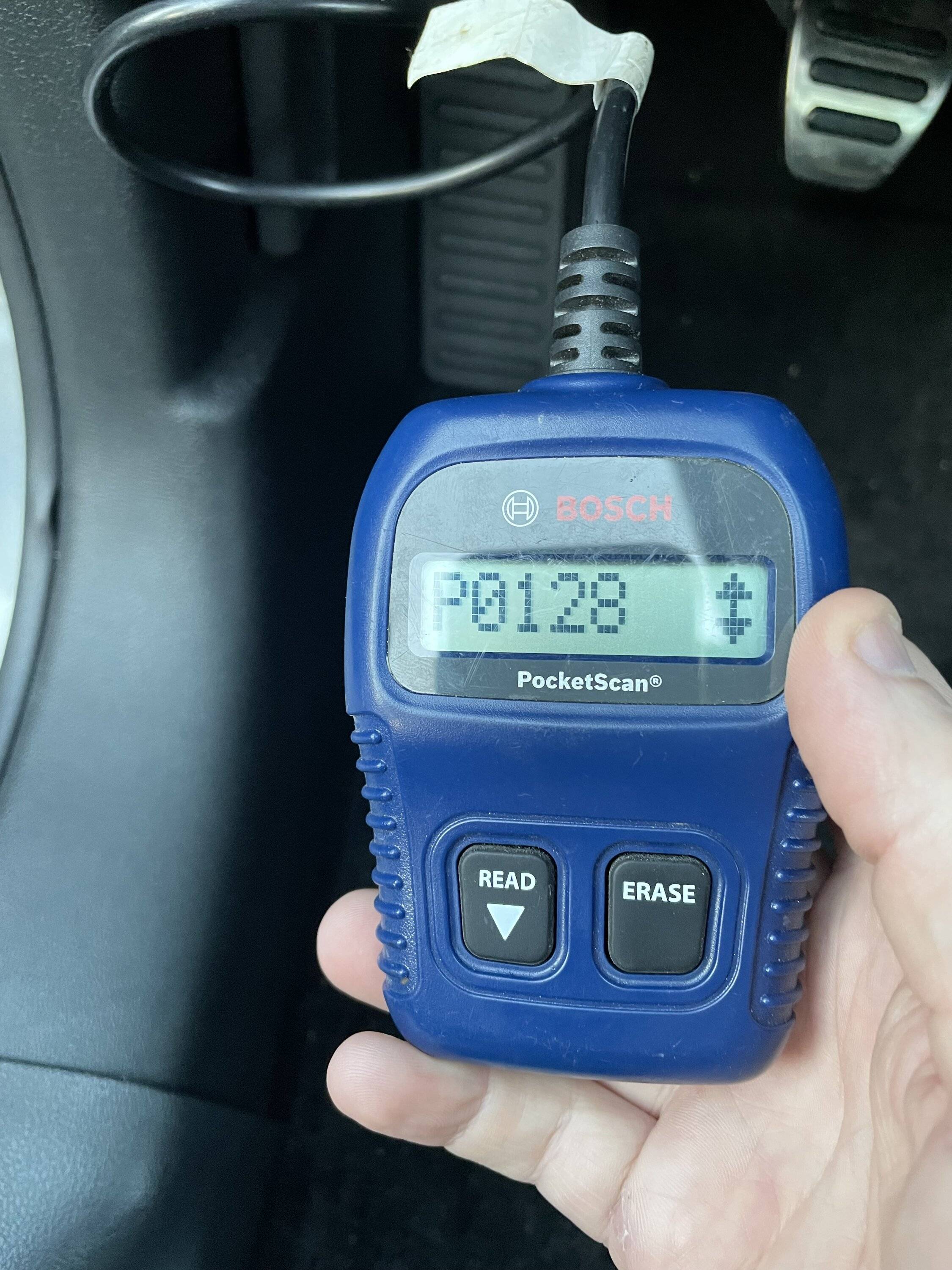

This forum has been very helpful to me over the years so I felt like it was only right to try to document my issue so hopeful it would be helpful to others.
I tried the soft reset of the system and the code would not reset. I did drive it a little and it wouldn't reset. I just borrowed a friend's OBD2 scanner but I think you can take it to an auto parts store and they will clear the code for you.

@68Stang How many miles do you have on the car? That engine bay looks like you live in world free of dust.
Congratulations on the level of upkeeping. I do keep my engine bays clean but this is another level...

Not dust free here for sure but I do stay on the paved roads and also spend a few minutes after each wash wiping down the engine bay. It's probably not as clean as it appears in the photos. I do drive it!!
As someone that considers themself a pretty solid semi-pro detailer, I would tell you this car has one of the best sealed (in regards to dust) engine compartments I've ever owned. I've never had a car with an engine that stays as clean as the one in this thing. Which makes be beg the question when I see one totally destroyed..."how the f#$% did you even do that?" LOL!
