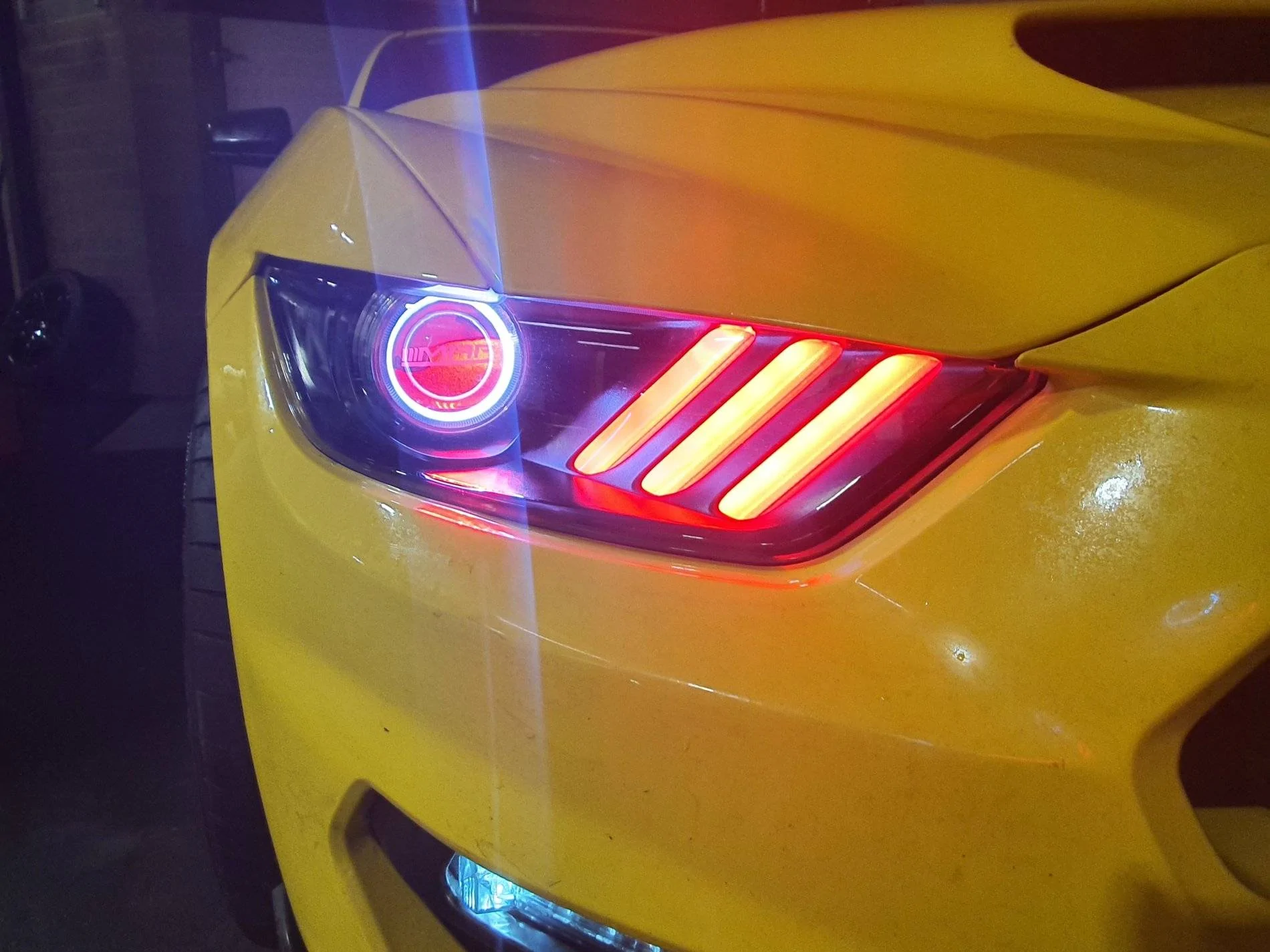

Motorsport and Performance are now offering some cool headlight upgrades I had mine done in Thursday
Blacked Internals
Tri Bars
Angel Eye
Demon Eye
Clear projector lenses that can have a logo etched into them
RGBW Bluetooth controlled
