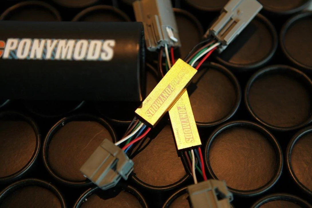

The Exotic Pony P&P sequencers are dead easy to fit - once you've got your sub out of the way. Worth noting that this gives you a red-red-amber indicator. Very cool looking though.

I've got DD front tribars and a custom rear setup, however, the EPM red/amber setup is the easiest for the rears now. (linked above)
They both require work to fit, you've got the following people I know who've done installs
Usman (@V8_MOTOR ) - has a guide for you to DIY the fronts, or you go to him with the boards and he'll do it within a few hours.
Mustang custom services - Mike Scott in leyland (Exchange basis - using another persons front lights)
AP Mustang - Adam price in Essex (Exchange or can do it to your lights if you wish to keep vin coding matching).
For the rears there's also the option of the plug and play solution by EPM, this makes you indicate RED/RED/Amber, it's illegal, it works, but i wouldn't recommend it, i was personally thrown off by it following @Gibbo205 when he was cruising with me, so wouldn't recommend the Plug and play solution and would go for EPMs full kit, albeit more expensive, but it's more professional looking, but again, more intrusive so it's strokes for folks and all that.
With any setup for the rears, make sure that there is the ability with the install to TURN OFF the sequential indicators as these are ILLEGAL AND WILL NOT PASS MOT INSPECTIONS (Due to 3 flashing lights).

If you do come to Howden on Saturday you can check out the cheaper EPM that I have on mine.
These are a relatively cheap and very easy fit option. They’re not quite sequential but they trick the eyes into thinking they are. They're also reversible where other much more expensive options aren’t. They have various modes of operation and you can switch them off from the drivers seat. Some early versions were buggy sometimes not functioning correctly. I have a set of those early ones somewhere which were replaced I’ll bring them to Howden
Other options involve cutting into the lights. They are more effective but more expensive and as I said permanent. And I’m not on commission so it’s a balanced view.
