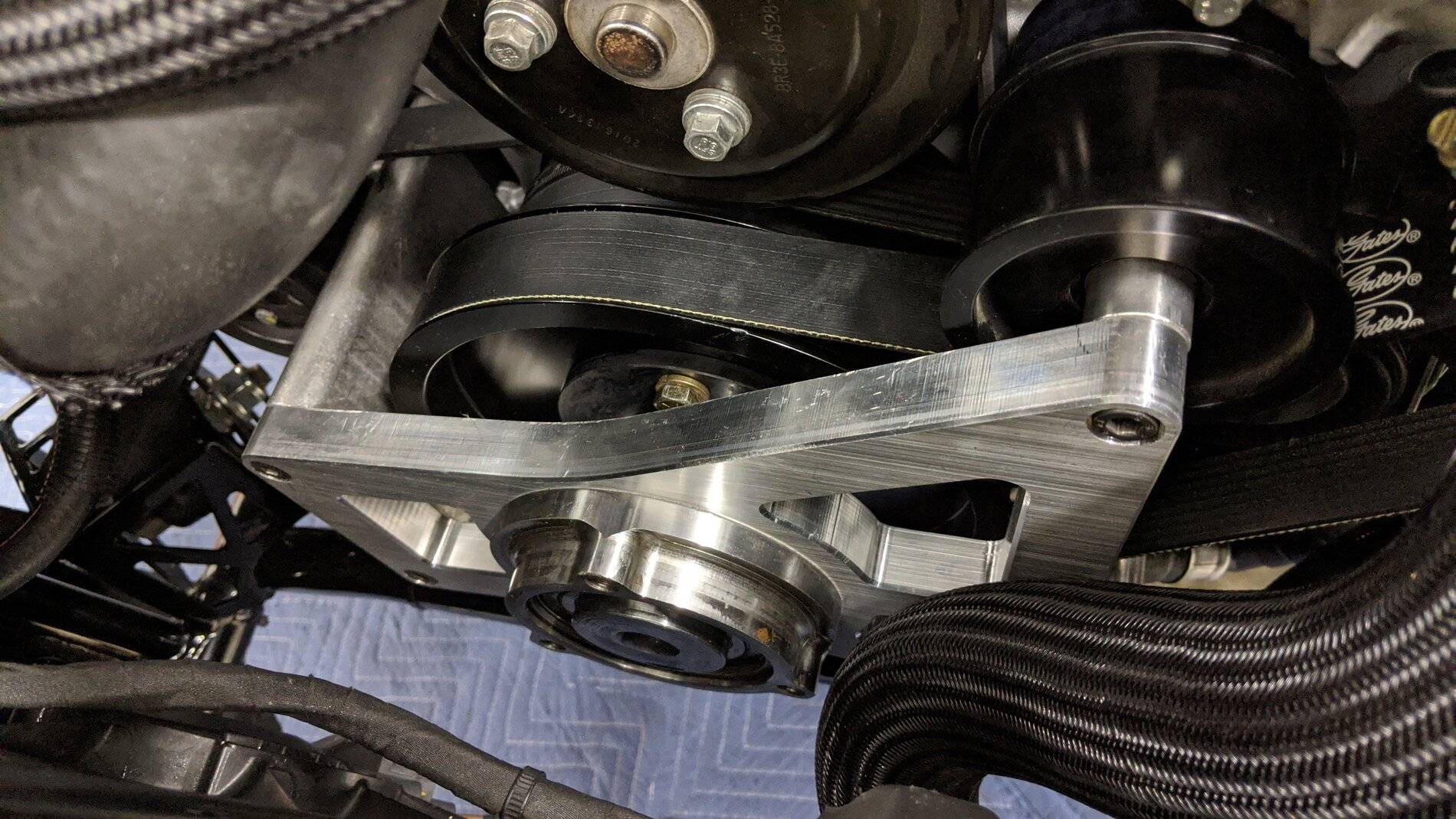

Turbo is the most Bang for your buck but definitely a lot more install and maintenance. Whipple is a great option. pro charger if you’re worried about stress on the crank you can get the H.O smog legal kit. it puts the procharger on the crank pulley without any spacer or added pulley
Meh on smog kit. Stage 2 all day. Crank support if youre scared of the internet troll stories.

I'm all for whatever factors are important (most) to someone in selecting a power adder, but I need to correct a myth.
Whipple's (and PD blowers in general) aren't hell on traction, it's your foot that needs calibrating.
You can drive a whipple or a TVS blower from stop light to stoplight very easily without spinning the tires. Just don't put your foot in it.
That's a tongue in cheek way of saying yes, if you want a setup where you can mash to the floor and have less of a chance of blowing the tires, a turbo setup (with sophisticated boost controller) is best, centri is better, PD is worst.
Also, if you're worried about the crank, you can run a support (as pointed out above) however you can't do it without losing your front sway bar (which most straightline apes don't care about anyway, but if you don't like driving a waterbed around turns, it matters).

Normal to light spirited driving i dont notice the absence of front sway bar.
