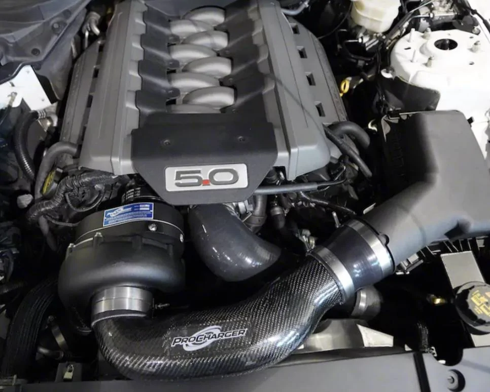

I have about 20 years of experience with procharger... From their first kits to race kits and everything in between. I currently have a hellion TT s550 making North of 1000.. BUTTTTT if it was actually my sole daily driver, it would be procharger powered. I've had several procharger DD's and loved every one of them.
Got this today from a customer.
ProChargerTECH
Oct 23, 2014
105
2,408
1,298
Boostville
2015 Mustang(s)
Briten Gilbertson
Procharger stage 2 d1x, 18k miles on it, not one issue period. No belt issues, Great iat, just get in it and drive it anywhere and makes great power. Couldn’t imagine doing anything different ever! Easy to service if needed. That coolant over flow tank location on the vortech/paxton kits a a joke.
Thomas Price
Ran the P1X on my 19. Super easy install and feels bone stock until you get on it. ~800hp 9.89@144 with no return system
Stephen Phelps
I got 80k on mine and about to.be at 850 to wheels on stage 2 with it
Here are more from yesterday...
