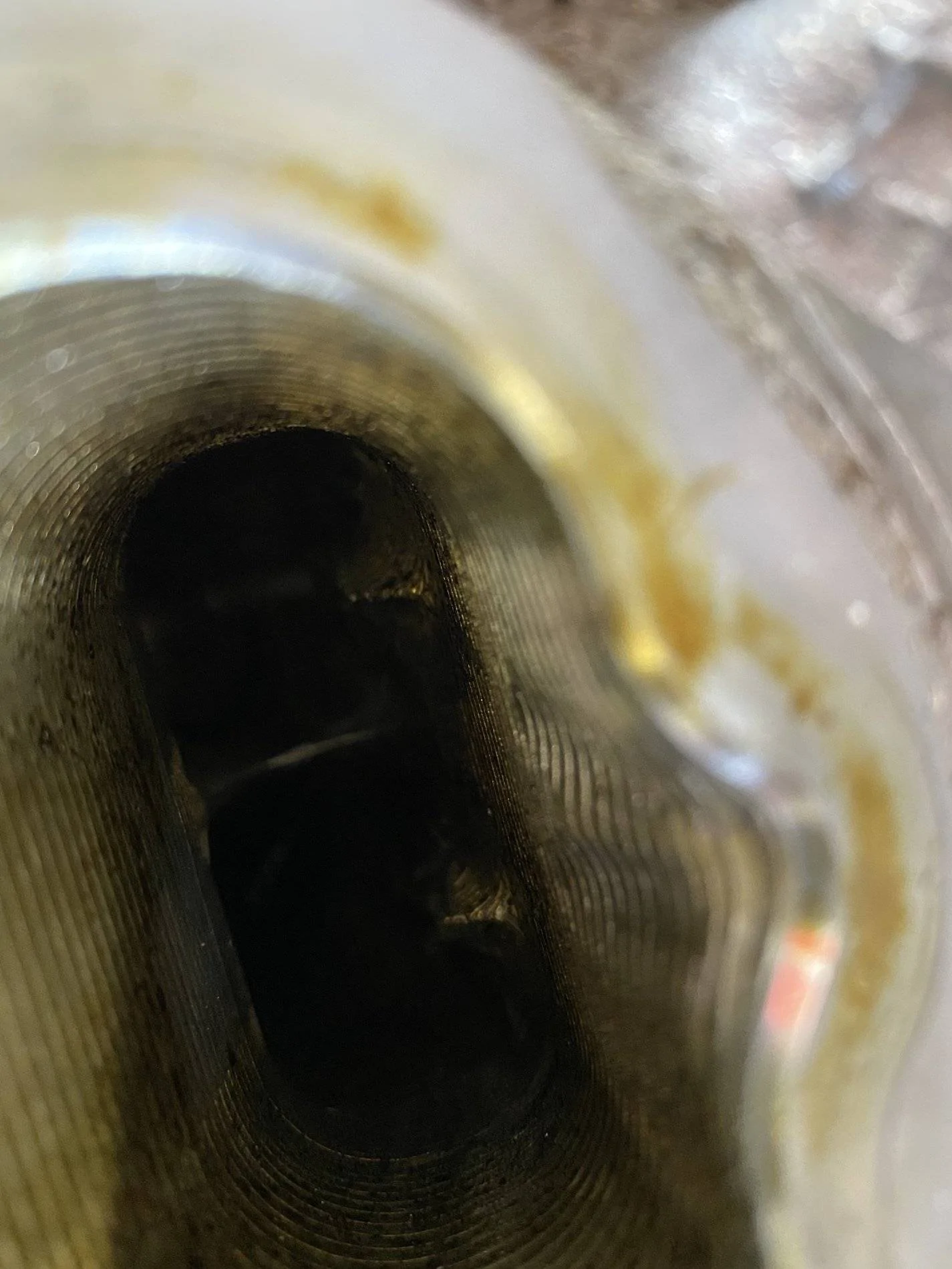

If you get a chance, just peek down the intake ports; the intake valves are the same as the GT350.

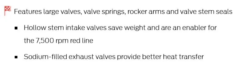

Tob, are the exhaust valves 2 or 3 piece, head, shaft and possibly tip? Is the stem sodium filled?

Hard to make much from that photo other than the valves look to be in position. Isn't that shot from the new engine? No dice on a shot of the affected chamber on your original engine?
I'd like more details too. From the Ford's eSourceBook...

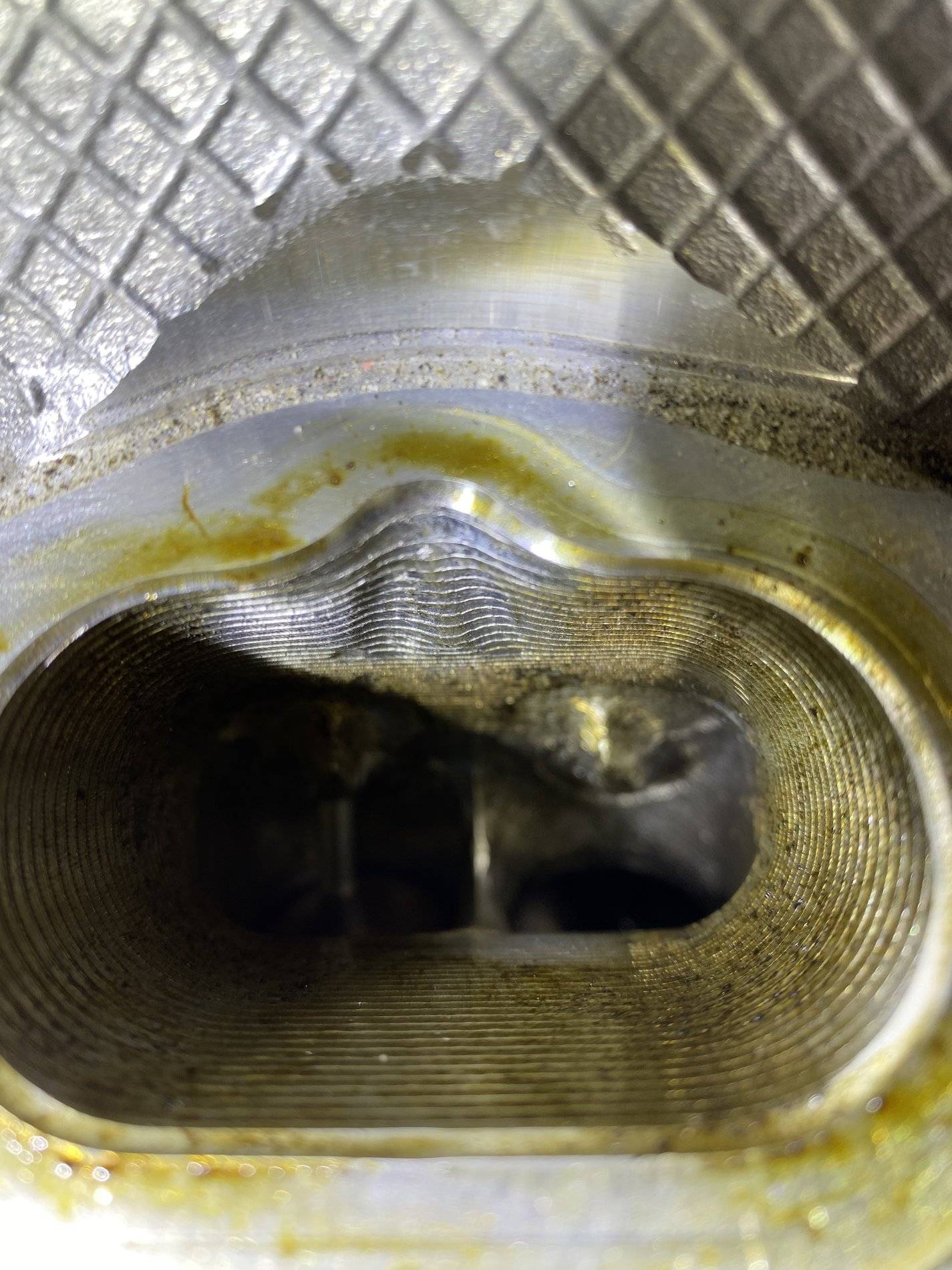

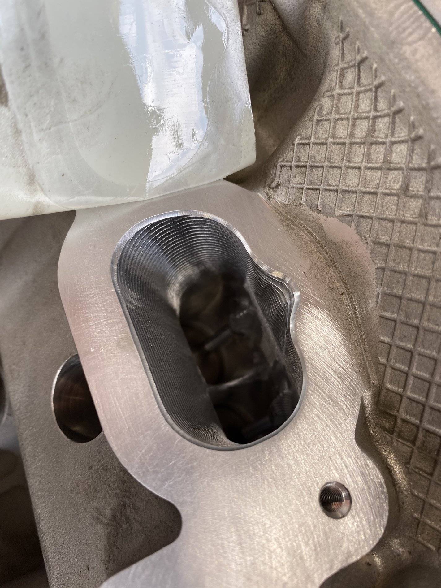

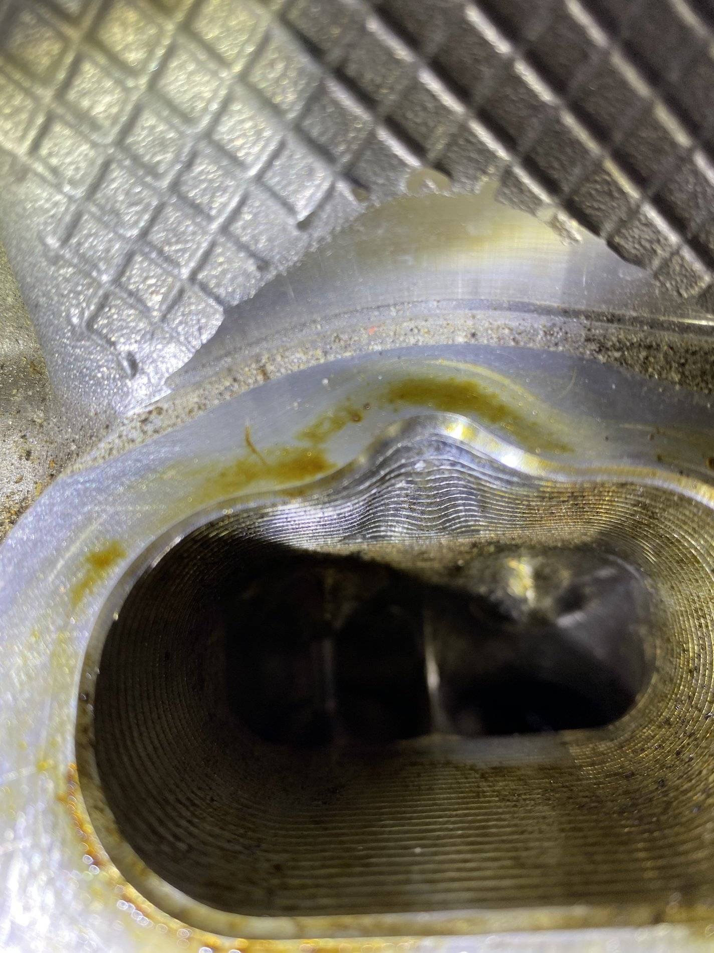

Little difficult to see but there it is in all its pride and glory! An intake valve sitting on top my piston!
Can’t get the engine back and tech not supposed to remove any thing further. So not true root cause will be found out. But delivery is scheduled for Monday!!

I find it strange that they didn't get any borescope pictures of the inside of the cylinder showing the piston, valves and combustion chamber. I wonder if it ingested a small part, the nicked SC rotor would suggest that?
