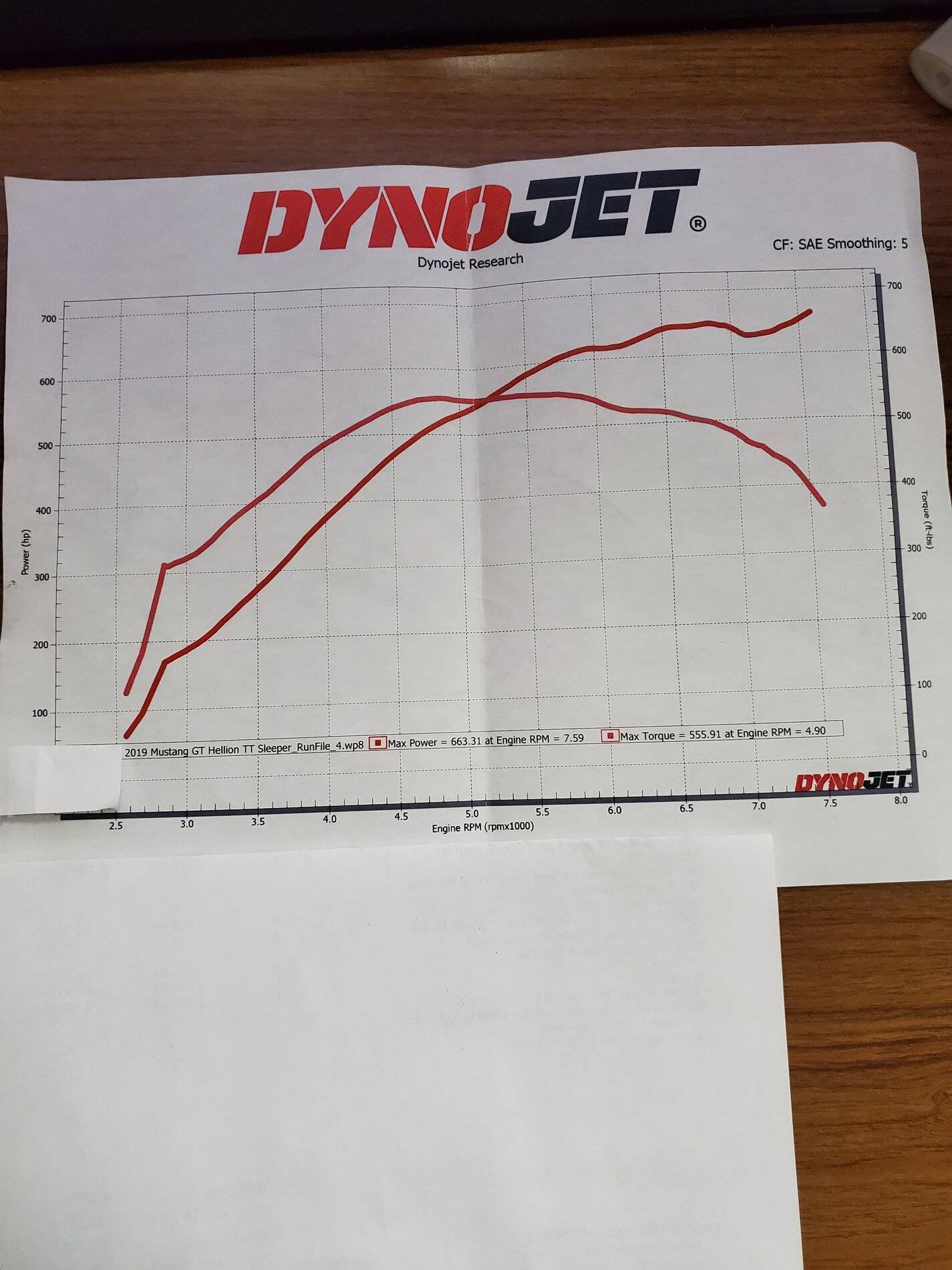

Holy shit, I didnt realize waste gate venting to atmosphere was going to be so loud. I held off on the boost controler, it made 660 at the tires on 7PSI waste gate spring.

They got it fixed. no more leaks. But I am going to get a catch can for the passenger side.
Get the controller. The controller is way more efficient than just running springs by themselves. Plus a push of a button will put them belt cars in your rear view mirror. :devil:
