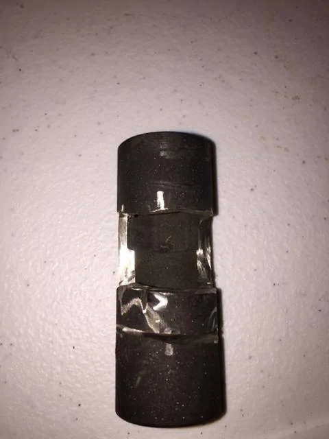

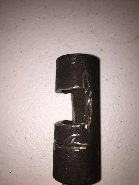

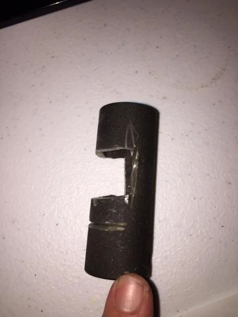

So rather than take it to a shop, I wanted to tackle this. So with the online images studied, I decided to make the tool. Beware the below pics aren't pretty... I clearly am not a metal worker, have no high end shop tools, no lathe, etc... LOL. But, here's what I did.
Went to Harbor Freight. (Figured if I am going to purposely tear up a good socket, might as well not spend a bunch of dough) I bought a deep well impact 21mm socket. Took my trusty dremmel tool with heavy duty cut off wheel and cut a window into the side of the socket.
I had to adjust a couple of times, because I needed to make sure:
a) I could get the 10mm wrench inside to hold the strut shaft top
b) I could actually turn both and get enough leverage to torque the outside.
This resulted in roughly a little more than half of the body side to side. This is a balance because you don't want to weaken the body so you can actually torque to specification (76ft/lbs I believe, thats the torque spec on the following thread see this post but I don't have a shop manual to confirm. So, proceed at your own risk) And positioned up/down with enough to again get the 10mm wrench on the shaft and hold the shaft.
Yes I found this thread and it discusses a couple of other Harbor Freight tools that may get it done, and an electric impact gun.
For better or worse, I did this and it worked perfectly. It only took a couple of minutes to torque the nuts and have a sound free front end again.
Did I take the harder, longer way?? I dunno?? But, this was the path I took. It worked. It ain't pretty. :tsk: I have no shame :ninja:
Well maybe a little. :doh:
