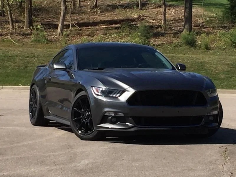

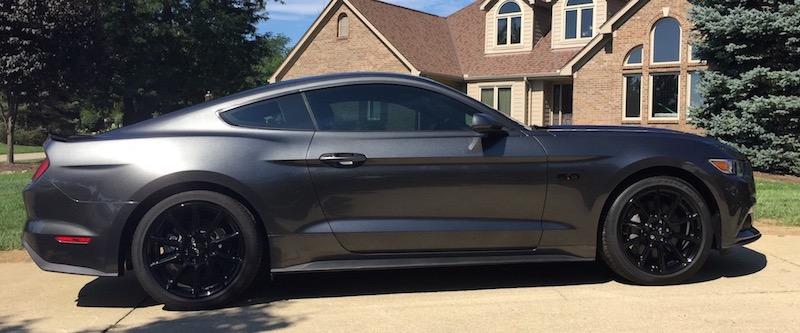

    Current pic:
    So many people, vendors, and groups have been huge helps along the way and I'll share that in upcoming posts. Hopefully I can keep ya'all interested.
    I want to see how much reasonable power can be made in a N/A build using the GT350 manifold, stock TB, CAI, Long Tubes, etc... before succumbing to the FI route LOL. I don't think it'll can make as much as a CJ intake would, but it will be fun seeing where we can go with a streetable build.
    Thanks for getting this far. :crazy:

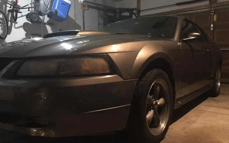

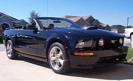

    I've had 4 Mustangs in my life. My parents are Ford and Mustang people, so we've had a LOT of both over the years (I think my dad has had 6 mustangs- his current is a 2005 GT convertible. He's in his 70's :headbang::headbang: )
    My personal cars have been:
    1986 Mustang GT- built and raced some SCCA Solo II Autocross (look at those baller pro numbers LOL- hey I was like 25 hahahahaha :shrug: )
    1996 Cobra - Beauty of an engine and suspension, especially after the 86 LOL. Built for Roadracing and 4.56 gears... fun car. (can't find a pic, but will update when I do)
    2007 Mustang GT/California Special Convertible.

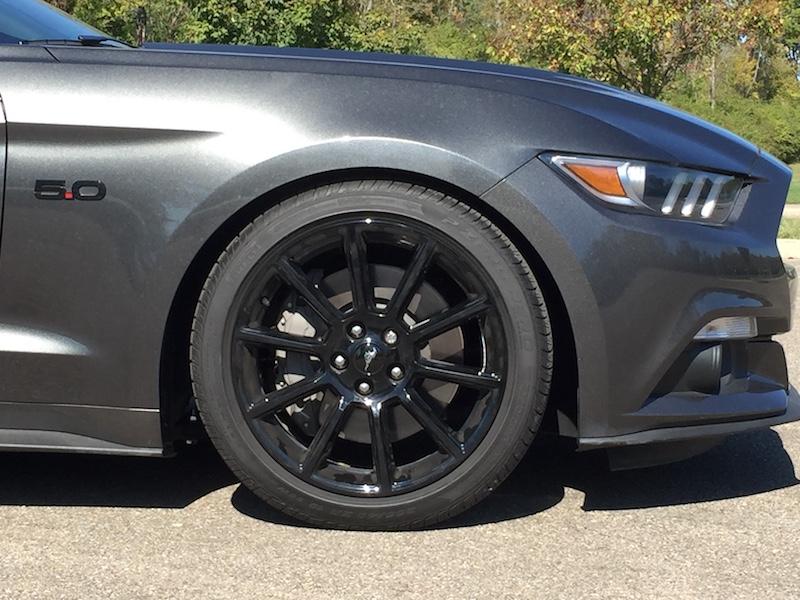

    Within the first 100 miles, the bug had hit (well the bug hit when I bought the car- I knew what I was going to do... hence why no PP. BUT... I wish I had them brakes). But I digress.... First mod- replace the exhaust.
    Holy Snikies! :eyebulge: I clearly hadn't seen a 5.0 cat-back in a while. Those things have gotten expensive $$$$. So, I got into conversation with a local shop. I live in SW Ohio and Team Beefcake is within 20 mins of my place. :thumbsup:
    [MENTION=10926]beefcake[/MENTION] (huge thank you sir!!!!) hooked me up with an MBRP full stainless street cat-back system. So with somewhere about 1,700-ish miles I put her in the air in the garage and installed the exhaust. Easy easy install.
    The stock system sat around until a couple of months ago and a local M6G member came by a picked it up.

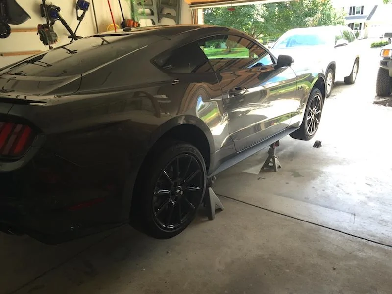

    A couple of weeks later (after exhaust install)... I couldn't help myself, and I put in a call into Steeda. You see- all of my previous Mustang's except the GT/CS has had Steeda suspension components. So naturally I was going to piece meal in their equipment. A quick call to [MENTION=7748][email protected][/MENTION] and I was all set with phase 1 - Steeda progressive springs for the S550. And... back up in the air she went. LOL
    The outcome:
    [​IMG]
    Also in those pics I added 25mm spacers all around- which IMHO really improved that way the wheels/tires look in the wheel wells.
    Now- one would think I was smart enough to get the jacking rails with the springs... nooo, I ain't that smart. :doh: But damn I wish I was.
    :crazy: I got those in the next order... with the G-Trac Brace. :ninja:
    Jacking rails- quite possibly the best sanity item ever purchased for working on a mustang. :love:

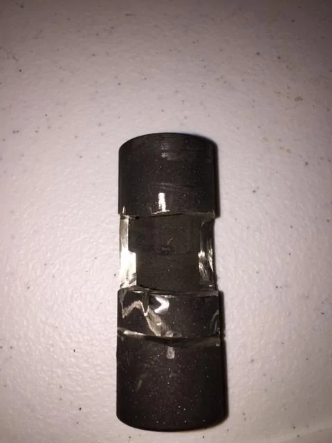

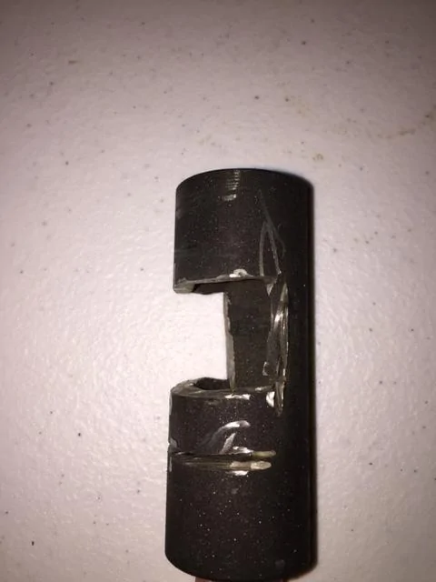

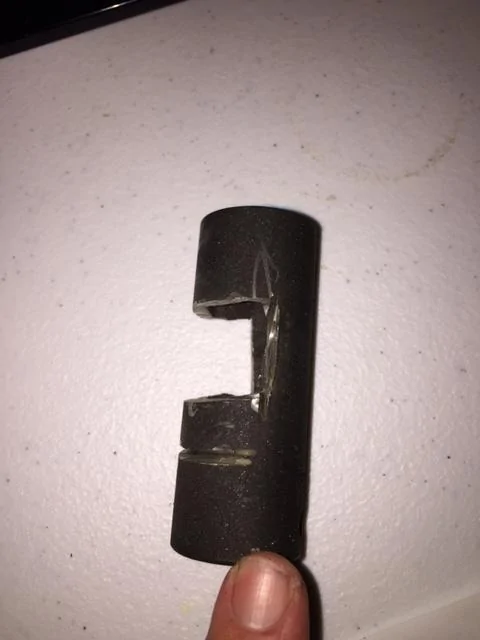

    Immediately after installing the Steeda Progressive Springs, I noticed I was getting a slight buh buh buh noise in the front end over any road imperfections or bumps. I started thinking- "well, crap... how did I mess this up?"
    So I hit up [MENTION=10893][email protected][/MENTION] to see what I did wrong. After a short phone chat- he knew exactly what I messed up. I had not torqued the top strut nut to specification after installing the spring. :frusty: I knew better than that... ugh.
    HUGE Thank you [MENTION=10893][email protected][/MENTION] . Not only did he get back to me fast, but was awesome to work with and was non-judgemental. His only concern was to assist me in fixing the issue. Kudos on the awesome customer service!!! I thank you so much :thumbsup:
    Now, at the top of the strut you need to hold the center shaft while tightening the strut nut with a torque wrench. Easier said than done LOL. I went searching online and could not find a 21mm strut socket. Yes, they make such a thing. I did not know this. I got a few search results, but they weren't available, or rarely available in that size. Oh there were some for other sizes, and I saw reference to BMW models for many of them. But finding the 21mm- no dice at that time. BUT- What I did see was a picture of the tool... Not complicated but also not available.
    So rather than take it to a shop, I wanted to tackle this. So with the online images studied, I decided to make the tool. Beware the below pics aren't pretty... I clearly am not a metal worker, have no high end shop tools, no lathe, etc... LOL. But, here's what I did.
    Went to Harbor Freight. (Figured if I am going to purposely tear up a good socket, might as well not spend a bunch of dough) I bought a deep well impact 21mm socket. Took my trusty dremmel tool with heavy duty cut off wheel and cut a window into the side of the socket.
    I had to adjust a couple of times, because I needed to make sure:
    a) I could get the 10mm wrench inside to hold the strut shaft top
    b) I could actually turn both and get enough leverage to torque the outside.
    This resulted in roughly a little more than half of the body side to side. This is a balance because you don't want to weaken the body so you can actually torque to specification (76ft/lbs I believe, thats the torque spec on the following thread see this post but I don't have a shop manual to confirm. So, proceed at your own risk) And positioned up/down with enough to again get the 10mm wrench on the shaft and hold the shaft.
    Yes I found this thread and it discusses a couple of other Harbor Freight tools that may get it done, and an electric impact gun.
    For better or worse, I did this and it worked perfectly. It only took a couple of minutes to torque the nuts and have a sound free front end again.
    Did I take the harder, longer way?? I dunno?? But, this was the path I took. It worked. It ain't pretty. :tsk: I have no shame :ninja:
    Well maybe a little. :doh:

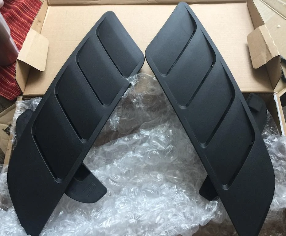

    Ok... well... I went to Cars N Coffee this morning. And it was an awesome turnout. It was c&c dayton, which moves the location around the miami valley (Ohio) each week. This week was Austin Landing.
    Great turnout, 4 parking lots full! Lots of Mustangs.
    But- (since this is a build thread) I had a de-build moment. C&C claimed a victim (or took a part offering for the cars gods). The Ikon Motorsport side louvers are no more. ;-) embarrassingly enough one came off on the freeway going home. So they have both now been deleted.
    Buh bye louvers. Buh bye. ;-)

    Also- kinda off topic. I picked up a 2002 GT Premium Coupe, 4.6L, 5 spd manual, black leather interior, Mineral Gray Metallic, 100% stock, no rust, garage kept with 98k miles as a father/son project car.
    Seriously though.... a picture says a thousand words. The look on his face when I told him it ours to build...
    :headbang::headbang::headbang: :ford:
    The mustang :love: runs in this family. Would love to get a pic sometime of my 16 GT, my father's '05 GT Convertible, and the 02 GT all together! So many miles apart but we may make something work LOL
    Plans here- 1st up spacers to run the Black Accent wheels off the 16 GT on this car. Cat back exhaust and lowering springs and new headlights already enroute. Oh yeah- we will start this one right. Now need to find a good SN95/New Edge forum for that build... anyone know of any??
